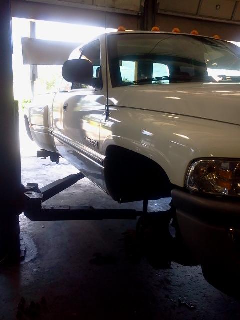

Yabba got new shoes today :thumb1:  Went with the Firestone TransForce HT post-1978-0-95295600-1402109098_thumb.jppost-1978-0-01557400-1402109101_thumb.jppost-1978-0-95246400-1402109102_thumb.jppost-1978-0-15711600-1402109105_thumb.jp Only took 3 tries to get the steering wheel straight... :doh: post-1978-0-37033400-1402109107_thumb.jppost-1978-0-29143600-1402109109_thumb.jppost-1978-0-29066900-1402109111_thumb.jp And then got a bath when we got home...post-1978-0-95446300-1402109112_thumb.jp Should be good for a few years :cool:  Next project, Injectors :thumb1:

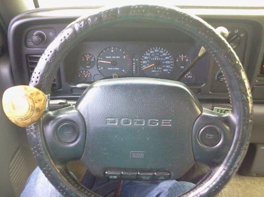

Well I finally got the truck aligned properly yesterday :hyper:  :hyper:  The steering wheel is pretty darn straight too :hyper:  :thumb1:   I went to a different Tuffy Auto up in Land O Lakes, and when he put it on the Alignment Rack and looked at the screen .... All that came out was a "OH BOY :doh: " and a sigh...  I said to the guy he made a lot of work for you didn't he?? He lowered his head and said YES :duh:   Anyway, Yabba is now walking a straight line and the steering wheel is straight :thumb1:post-1978-0-45811300-1403365444_thumb.jp

Just got around to doing this adjustment today after rotating my tires and greasing up the front end.  It is really easy.  Took longer to test my adjustments driving around the block after each of three tries.  Thanks again!!!! :thumb1:
