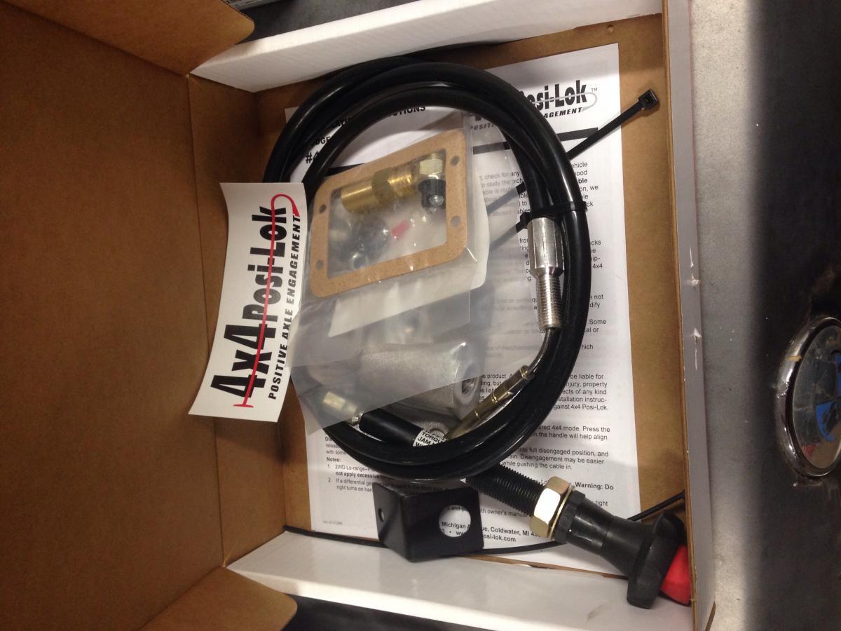

Buzz, I like the thought of the manual cable hook up, if I'm thinking of this correctly, wouldn't that also give me the ability to have a 2low? To be honest that would be nice.
I haven't installed it yet but you could try this.
mine is  on the way..    ordered last  Fri.
and  yes   2wd low   is   a  benefit.

If you go with   manual hubs,   like   CSM  said,    you'd   just lock  this  shift fork over  into  'lock'..  I've  used  a stack of  washers to hold  it in place.
