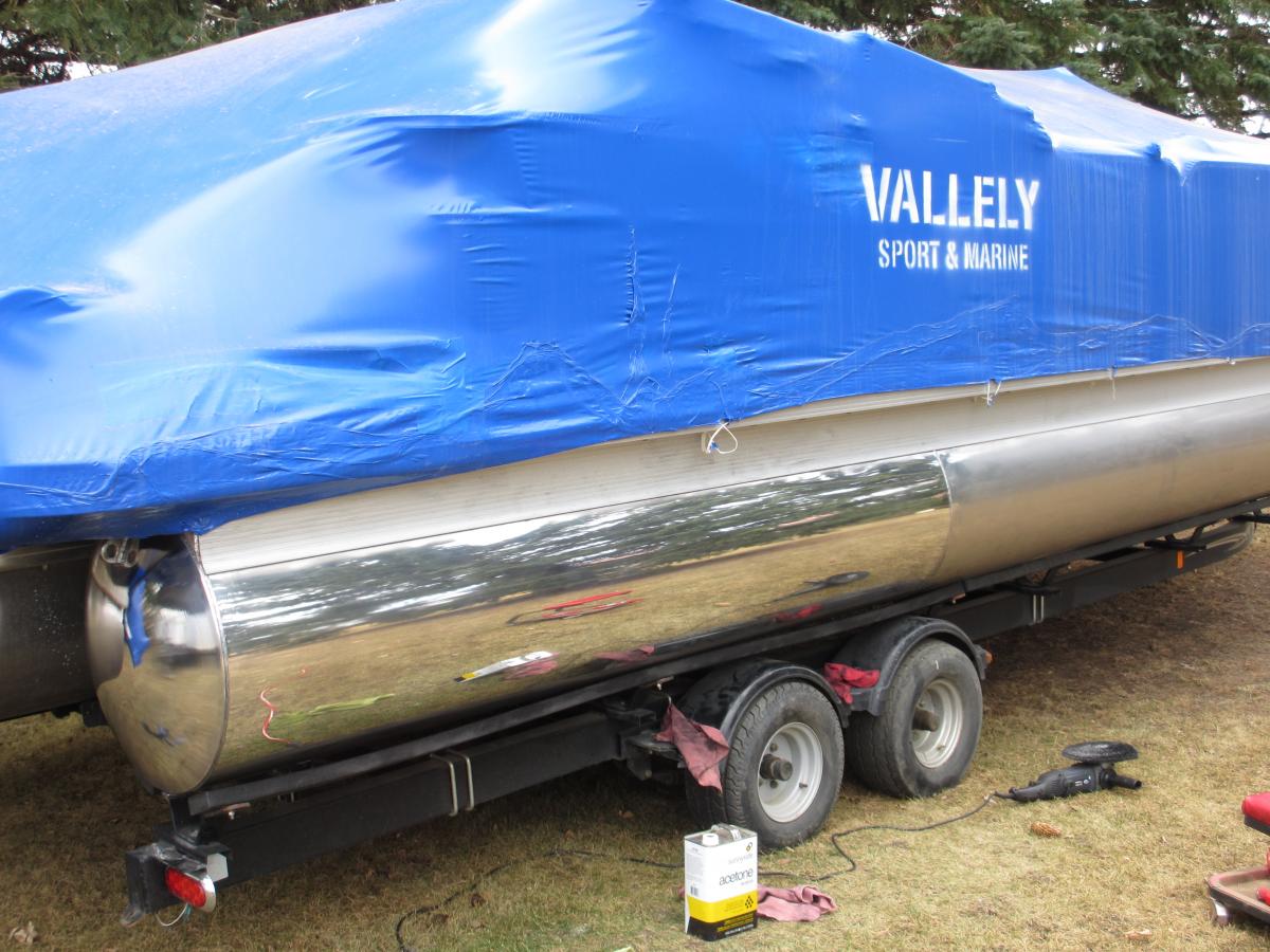

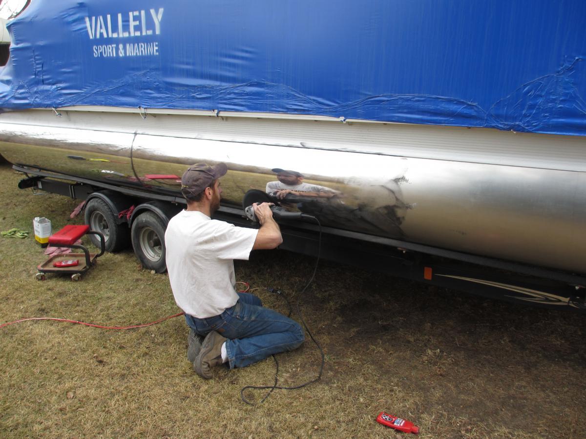

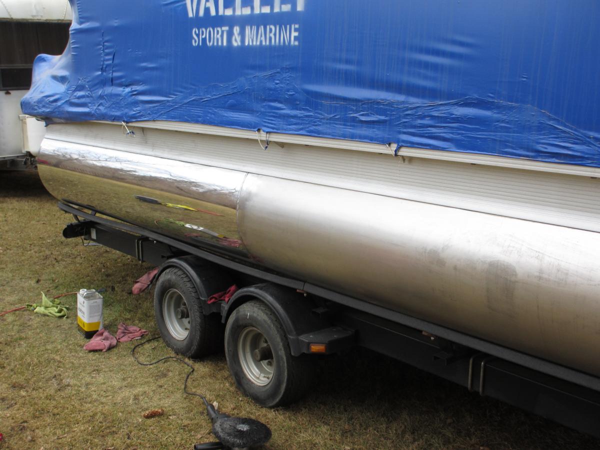

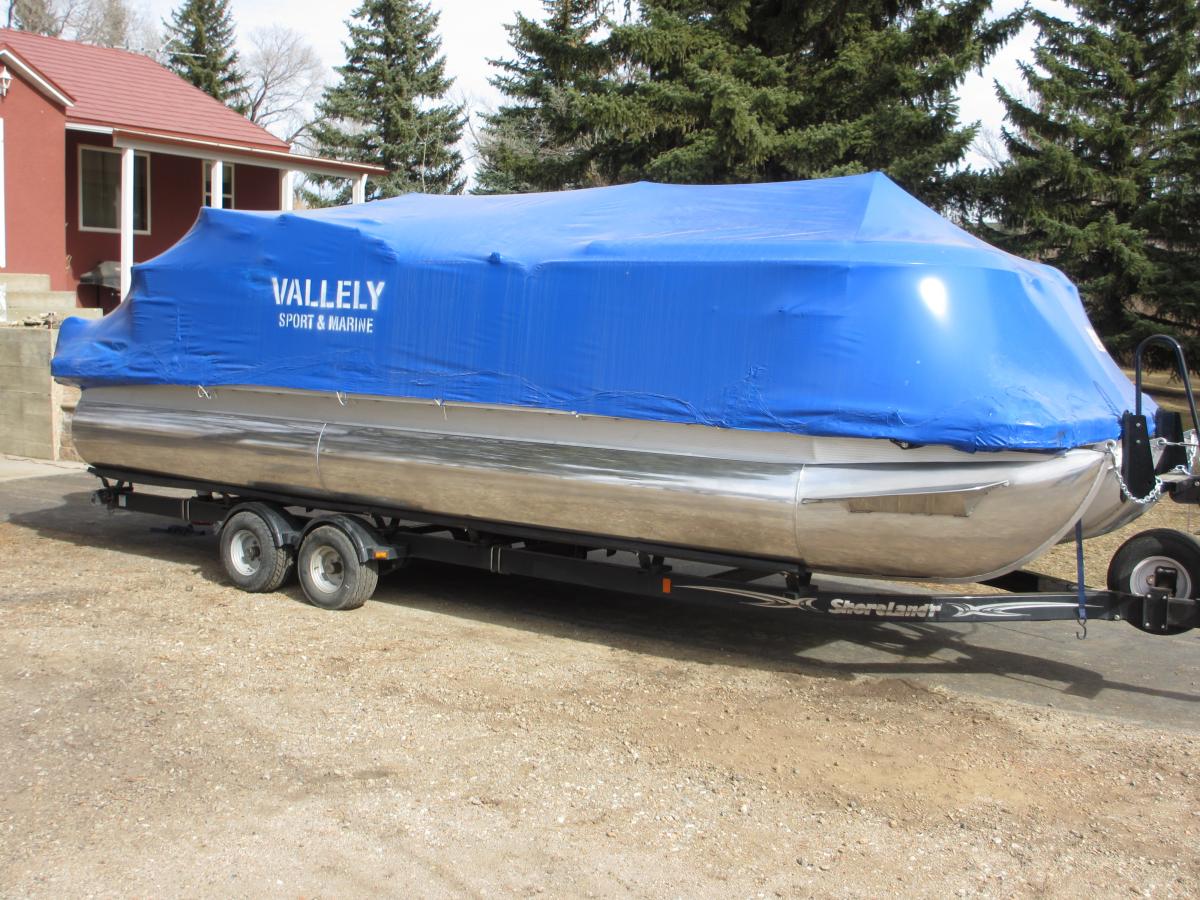

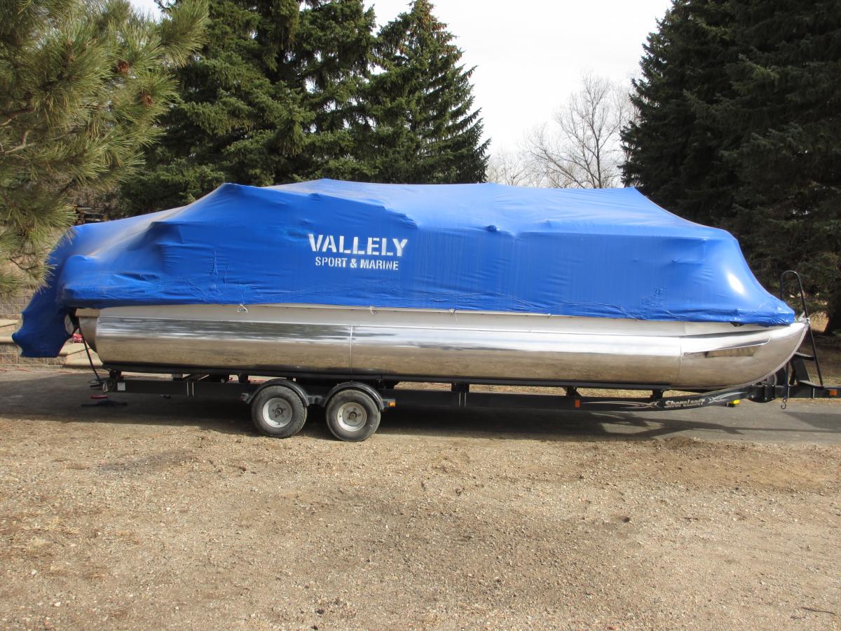

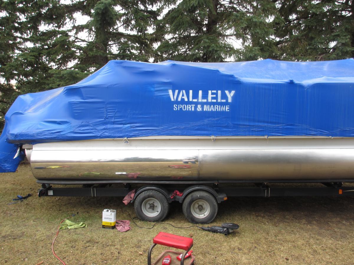

Decided to polish the tubes on my pontoon finally, Did it before my last pontoon ever saw the water, but as one gets older the ambition factor diminishes but last weekend it was in the 70's in march woo hoo!!! decided to get it done before season #4 on this pontoon. some pics of the project. 14 hours into doing just the outside of the outer tubes and the rear of both tubes and a sore body for 3 days after. Used Mothers aluminum polish, there are a ton of different metal polishes out there but this was readily available and easy to get and it worked on my last toon so I just went with it, used a standard variable speed buffer with a wool pad, after the final wipe down with acetone and final quick hand buff I put 2 coats of Sharkhide on it to keep them looking like this for years. Sharkhide is basically a clear coat for aluminum which has a chemical make up to it to prevent etching of organic growth and barnacles to adhering to the aluminum like you see hanging on boats that are kept in the water, they can still be on this but it will easily pressure wash off versus the harsh cleaners or acids and washing and scrubbing needed if they were allowed to etch into raw aluminum.
