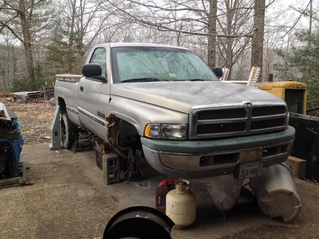

  1. Hi Jman, Well thank you for your question. This truck is still project truck. Currently way laid with other projects. I am happy way the truck sits. Expect it will ride well. In the thread below on July 25 2019, there is a picture of the truck in the background on my concrete pad. https://mopar1973man.com/topic/16281-99-ole-rusty-cab-rust/?&page=2#comments Will post a current photo this weekend when weather is nicer (not raining). Bob G. Ok here is the truck as it sits on the concrete pad.

  22. Agree with what every one has said. Truck is on a gentle concrete slope in front of my shop. So glad to see the front axle finally hanging there since it was removed four months ago. Planned to hang the traction bar to see the change. Right now as the truck sits, C-C is 36" and on the traction bar measured C-C about 38" . On Sunday scrambled to get the traction bar, sway bars, drag link and tie rod link degreased, wire brush, POR 15 and then Rustoleum top coated twice before it rained in the late afternoon. We are suppose to get 5 to 8" of snow tonight and freezing rain in the morning. Hoping to get the axles and hubs in tonight. Debating at this point to just throw the old coils back in to compared. Wished I had done that before pulling the front axle out. Bob G.
  23. Ok Sprayed the front axle with POR15 and top coated with Rustoleum last Wednesday. Installed the front axle on Saturday with new Moog CC1712 front spring set. Measured the installed front coil springs... Driver Side Loaded Height: 14 7/8" Bumper-Axle Gap: 3 5/8" Pass. Side Loaded Height: 15 1/8". Bumper-Axle Gap: 3 7/8" Do these numbers look right for s standard stock #8600 lb truck? Thanks, Bob G.
