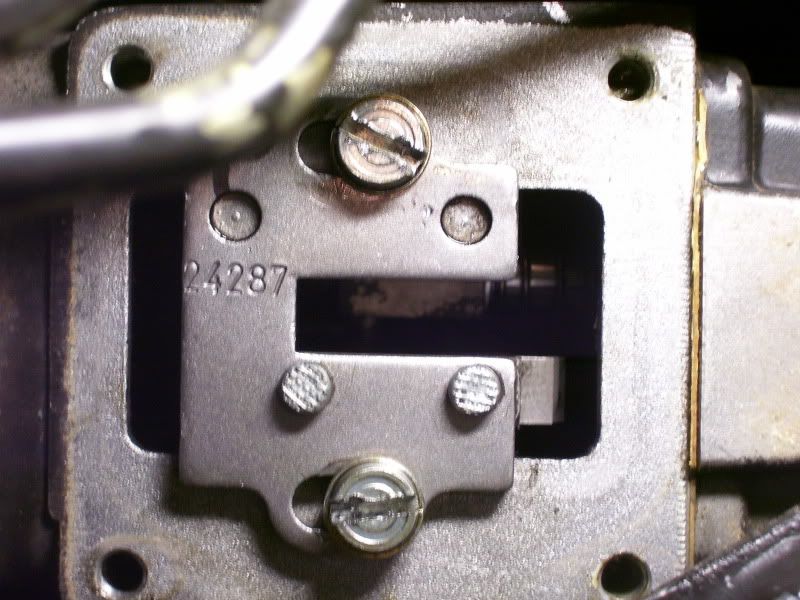

I apologize for the late response to your comment you sent to the website.  First off, thank you for your interest and taking the time to type out your questions and concerns.  With regard to your current 12 valve, it sounds like you have a solid combination to work with.  In our experience, a fresh (less than 50k mile) transmission with a shift kit is capable of handling around 425 HP at the rear tires, if the converter was also upgraded, you can stretch that to almost 500 HP to the tires.  With those assumptions, you can pretty much add enough fuel to max out your stock turbo before worrying about the transmission.  Around 425 HP is the max we see from the factory HX35 when pushed to around 42psi boost.  The stock turbo doesn’t last long at that power level so if you’re looking for a long-term reliable setup, you should shoot for 375 HP max with occasional 400 HP blasts (for fun)…
If you were to install AFC LIVE stage 1 and follow the instructions for AFC modifications, removing the stock fuel plate, etc. you’d end up somewhere in the neighborhood of 325 to 340 RWHP up 155HP roughly from the factory 170 or so to the tire.  This max power can be turned down with the power knob back to below stock if you turned the knob down that far….  To get that extra 50 HP to reach the 375+ HP goal, a mild set of our Budget Builder Injectors or Power Driven Injectors would be a nice combination.  We custom build all of our injectors in-house and stock the components for most sizes so lead time is just one to two business days for injectors.   XXXXXX XXXXX (I removed the vendor name since this was addressed to me, Greenlee) produces a fairly high quality injector from the sets we’ve worked on, tuned up, or modified but obviously we feel we offer a better product.  Our more premium Power Driven line of injectors are made with high-end components and give you the option of the standard quality Italian steel based nozzle that is then EDM’d here in the USA to the various sizes or the upgraded Bosch based nozzle that is also EDM’d here in the USA.  (Bosch nozzles come from Germany, Brazil, Italy, etc. depends on the nozzle type).  For your truck, I’d either recommend our Budget Builder 5x011” sac injectors or our Power Driven 5x012” Italian steel sac injectors.  If you’re the type of person that only want’s name brand products, then select the extra $100 option for the Bosch based Power Driven Injectors.

Normally automatics defuel between 2300-2500.  By installing a GSK (Governor Spring Kit) it lets the engine rev to 3000 or 4000 RPM before defueling.  You can install a 3k, but I would install a 4k as the 3k will start to defuel ~2800 and the 4k just drives better.
