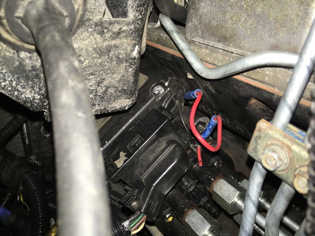

One other question, whats the best way to tap the pump wire? obviously there are the T style connectors and such, but I've heard guys say there are better options and Ive seen one that screws together as well. Whats the best way to go? and also the most weatherproof?

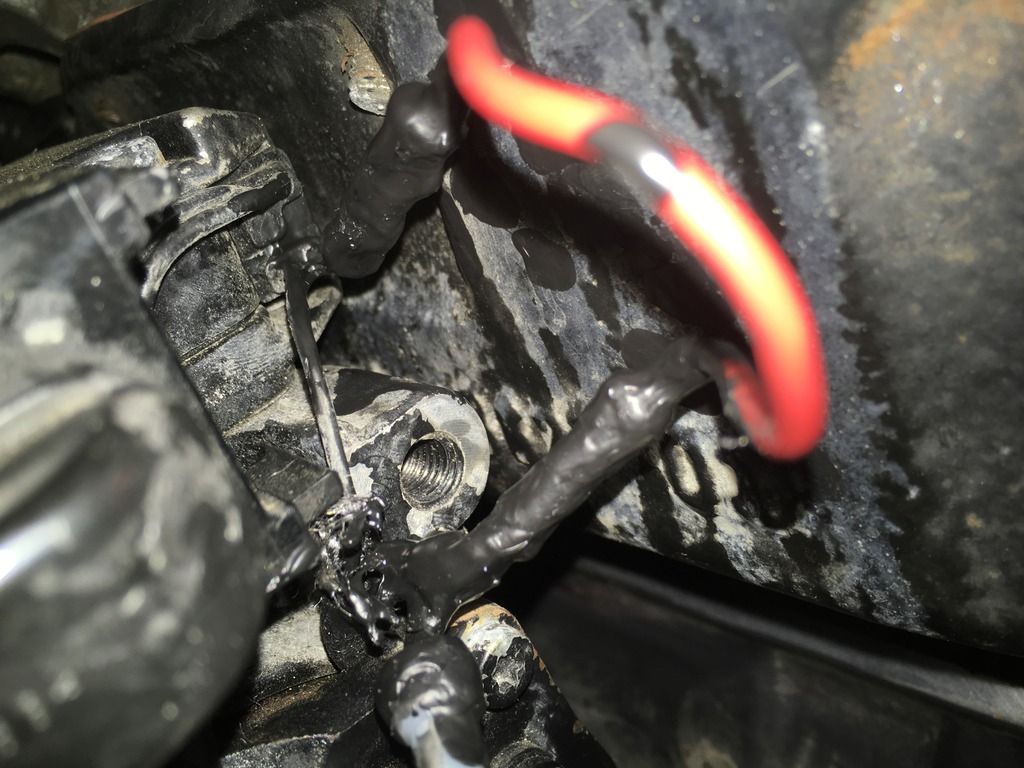

I have seen those and I would definitely go that route except for the fact that my pump wire was tapped in the past. One of the PO's cut the wire and spiced in a little bit longer loop. He also added an extra leg out one of the butt connectors to make it easy to connect to. Shortly after I bought the truck, a place that did some work to the truck for me, cut that wire off way to short to do anything with other than crimp a cap on so that it wouldnt short against anything. Until now I had no plans to ever tap the pump and I almost cut that mess off to fix it all correctly with solder and adhesive lined heat shrink. But as I was getting ready to do it, I decided as long as everything works just fine, it wasn't worth messing with and risking ruining the pump or at least having to remove it to get more space. So I just liquid tapped all the ends of the connectors to protect them from moisture. Sometime in the future I will remove the pump and fix it right, but until then a regular wire tap will be fine and save me the $70.
this is what it looked like
this is how I "fixed" it. I know its a mess, but hopefully it works for a good long time.

You mean that's what you would do to fix it properly? Or that's what you would have done to begin with?
I would have used them to begin with if it was me, or if I thought I had room solder and heat shrink. I'm pretty sure I can't do either at this point without removing the vp. Just not enough room in there. I think that liquid tape will hold up for a good long time though. And there's no reason, in my opinion, that a crimped connector like that should fail as long as it's protected, which, with the liquid tape it is.

without removing the vp44 your choices are limited.
I would have used a weather proof butt connector at least if I was the guy that owned the truck before you  I would still use one now, but I am not sure how much good it would do.
However depending on what my weekend looked like I would prob pull the vp44 and fix it.  Pretty easy to pull the vp44.
Well I may just do that sometime soon then. Is there a reason not to solder the wires? Or why so keen on the heat shrink butt connectors? I mean I like them too but isn't soldering better?
