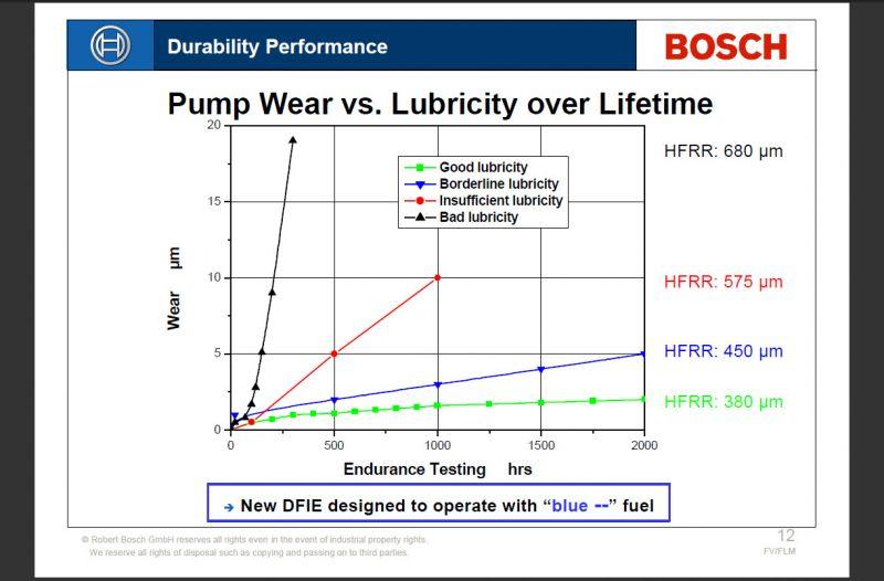

Adding the 2-stroke oil did seem to quiet the engine down some. You guys are right about the valve adjustment too. The ticking noise is coming from the top end of the motor....i can almost hear it right underneath the valve cover....i haven't pulled the cover off to check them....i got to get a feeler gauge first....weird thing is that this truck has 40,000 miles on it.....i've seen where some people said in DTR forums that they had to do theirs way earlier too, but i think it was mostly on the 3rd gens.....hopefully the ticking will go away after the adjustment....Thanks for the help.....
