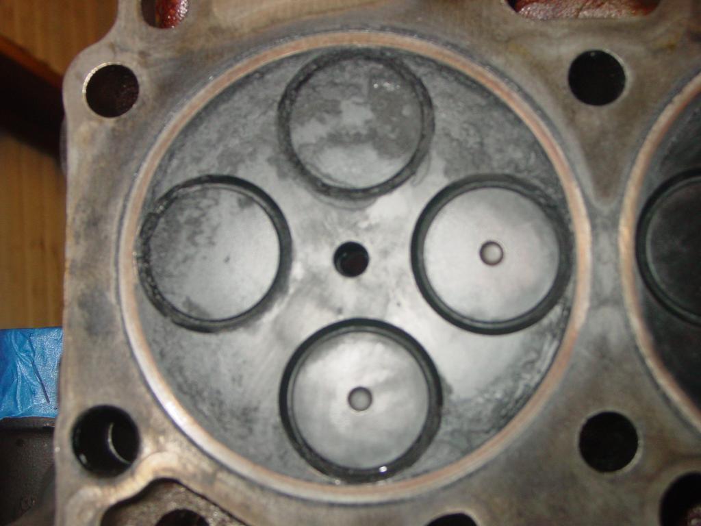

Ok for you that are still with me and interested here are some pics of the head off. I did not have any burnt pistons! The cylinder walls look good except #1, as far as I can see of it, without turning the motor over. Sorry it got too late and had to get up at 4:00 a.m. for work.post-10167-138698185261_thumb.jpg
Is there any crosshatch left in the cylinder bores? Looks to be a bit carboned up so at this point I am leaning towards bad rings from excessive idle time and or poor quality oil or having been dusted from a bad air filter. But will hold final judgement until I see more of the pistons and better cyl wall pics.

Wild and Free Yes there is crosshatching in all 2 thru 6. They look great. I have not turned the motor over, due to time, on number 1 yet. So, it hard to say on that cylinder for sure. As for the poor oil, excessive idle time, or poor air filter. I, again assure you these are not the case! I am anal on maintaining my trucks. I personally change the oil and filters at 6,000 miles. Or if the filter looks dirty I change that more. As I go along I will send more pics. I got another gentleman that is wanting me to ake the valve springs out and check the valve guides and seats first. I might do that first then the piston removal.

What's going on with this piston? It's awful clean, and the areas I highlighted don't look right, could be just the light. Which hole is that?[ATTACH=CONFIG]3723[/ATTACH]
What's going on with this piston? It's awful clean, and the areas I highlighted don't look right, could be just the light. Which hole is that? [ATTACH=CONFIG]3723[/ATTACH]
Nothing wrong with any piston! Except #1 oil deposit
Ok so it was just the way the light was reflecting. :thumbup2: It looked like maybe some detonation going on because of the light. Piston is still awfully clean, doesn't have any carbon build up from the way it looks in the picture. You mention possibly loose head bolts, and a replaced head gasket. What happened?
