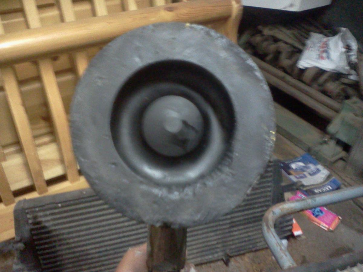

i took everything out except the crank. he said the cam looked good and the lifters were fine. i posted a pic of the lifter on a earlier post but i don't have a pic of the cam. the motor seemed to be in pretty good condition other that that #2 piston.
