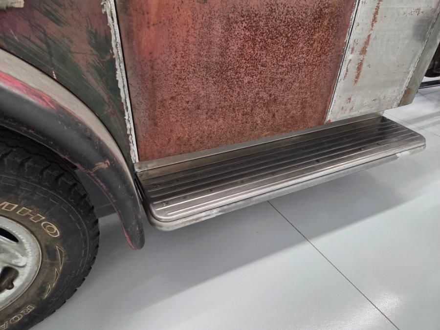

Passenger side door lower cancer repaired.   And of course my air compressor pressure switch took a dump again...another switch on order to see if the motor is driving the over amp on the switch causing the wire melt.
passenger door gaps built out

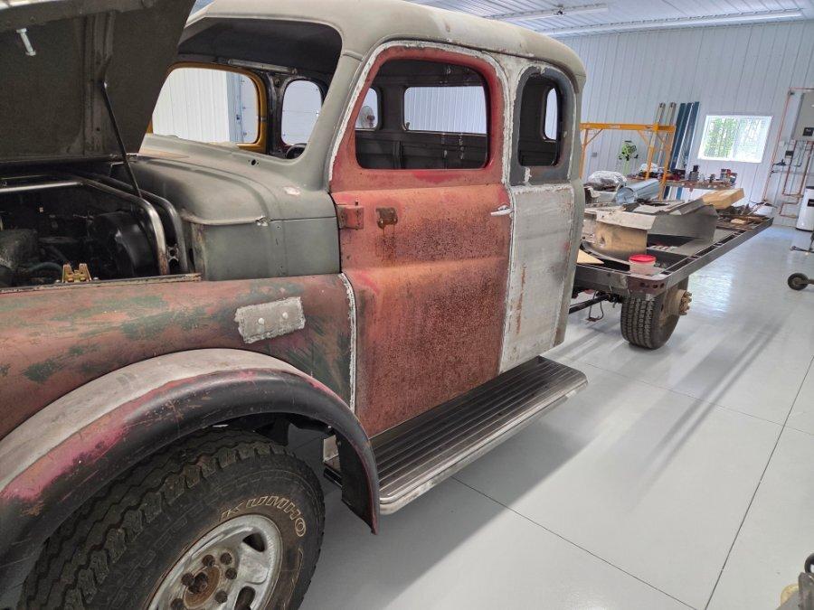

Dialing in the rear door windows with glass in hand.   A few minor adjustments needed.
Driver side is giving me a few isues getting it all lined up happy with the passenger side.   Even a vaunted template failed me and I'm down to itterative pivot placement.  I'm close, but not quite yet.

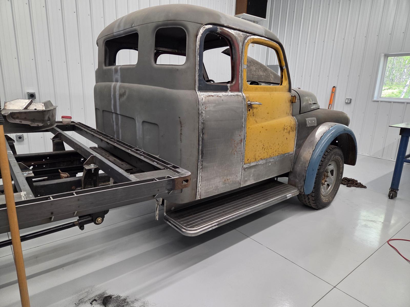

Driver side now w/in 1/2° on angle for open and closed position.  Tonight I fully weld the pivot point in place.
Tip linkage pivots all welded in.  I do have some heat deflection at the front pivot to deal with, but not that big of a deal.  Also dropped the turbo back on with the new spacer for clearance.
