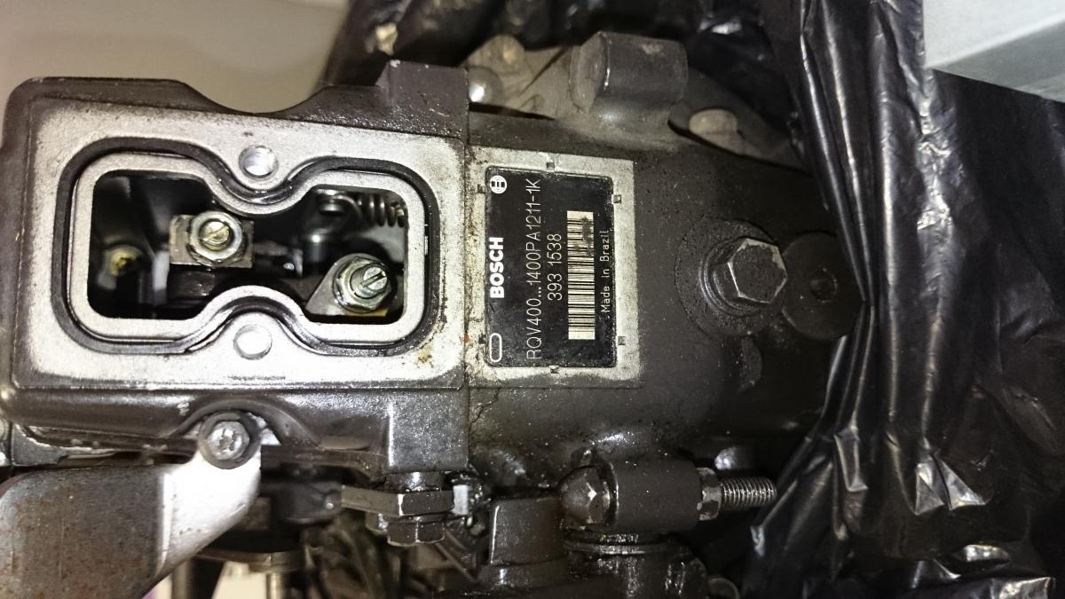

Ok, since I put the new 60hp injectors in the idle seemed to be set too low... I would have to turn the AC off whenever I came to a stop otherwise the truck would run rough and even stalled a couple of times... I would have taken a video however it was just a bit too tight to stick the camera in place and get a decent shot of what I was doingno.gif so, I did the next best thing and took some photosyes.gif (I adjusted the screw with the truck running)

I had to do the same thing on a customers rig as well. It was idling a bit low. Boy talk about butter fingers... I must of dropped that 10mm wrench a dozen times before getting done with the project. But I got it idling about 750-800 roughly and customer was tickled. I can tell you that you can barely see the top of the bolt from working on top.
And for the 24 valve guy, where exactly is this screw located?
It's on the the very back of of the P7100 injection pump. Look at the back there and see the bolt and jam nut.
This is one of those type of jobs that you can do better by feel because you can't really see what you are trying to do.
Umm Mike, I thought the 24v had a VP44 injection pump not the p7100 like the 12v??? :ashamed: post-1978-0-60321500-1412049522_thumb.jp
I think they were just referring to the fact the a vp44 guy wont know what you guys are talking about, or where that adjustment screw is. You are correct the 24v does have the vp44.
Umm Mike, I thought the 24v had a VP44 injection pump not the p7100 like the 12v??? :ashamed: attachicon.gifp7100mike.JPG
Ummm... :think:  Yes, that was what I was figuring on is that most VP44 owner won't have a clue where a P7100 idle screw is at.
As for the VP44 it doesn't have a idle screw at all. Even the stop screw on the APPS sensor is NOT a idle screw. The idle is completely ECM controlled as long as the APPS sensor is providing the IVS (Idle Validation Switch) for idle then the APPS sensor is ignored completely and the ECM controls idle on it own by software. VP44 injection pump is completely fly by wire there is no throttle attachment to the pump like a P7100 injection pump.
