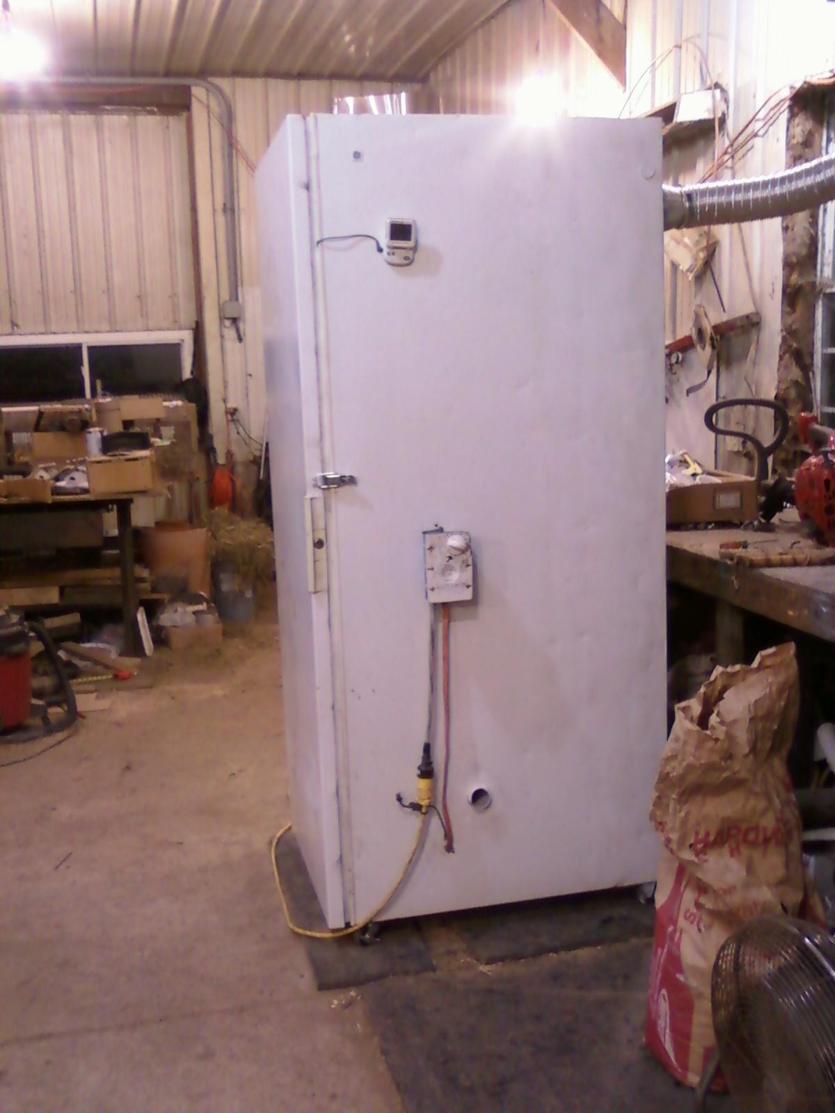

Yes, thats what it is..... a chest freezer set on end [up right] w/ a 8;; elec. stove top burner [w/controler] under a drip tray [VERY IMPORTANT!!!!   :nono:   'i know!] . then a 5'' stove pipe exh. [no drone here!   :duh:  , just drooling neighbors .... :drool:  ........] with chimney damper, racking to hang ham & bacon and a lock to keep mopar friends out! [they just might burn fingers & such.... :lol:  ...]

as i type, i just started adding hickory chips to the pan on top of burner......stong stuff!! burns the eyes! but wait till the smoking is about done!! oh, yeah!! sizzle!  :drool:

Any issues with the insulation or door gasket getting to hot? I've heard that can be an issue.
Edited by Buzzinhalfdozen
no, not yet! i keep i close eye on the temps. max. [supposed to be  :ashamed: ] is 180*f
What DOSNT work is to get fat dripping & getting THAT on the burner!!!! UP IN SMOKE HAS A VIVID MEANING!!!  :cry:  [hams & ALL!] this is my 2nd smoker..  :yme:
uhmmmm, yeah, i DID see some blistering of the plastic corner trim..... i'll use metal trim & MAKE it work!  my other smoker was an OLD heavy SEARS,.....THAT one didnt have any problems , OLD is tougher some times.
