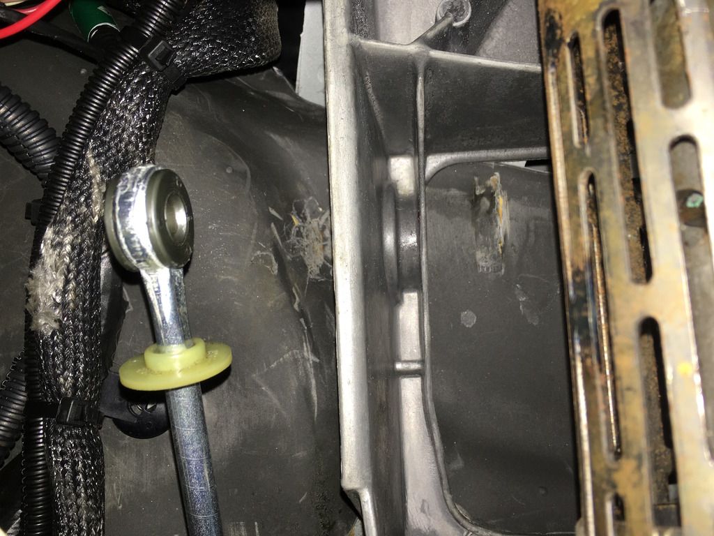

The first thing I found that I didn't like is that the spring clip that holds the brake pushrod to the pedal was worn out and a washer was added to the pin to try and keep it on there. Who knows when that would have slipped off. The other thing is pictured here. Would done of you guys mind checking your brake pedal to see if you have this? I'm talking about the silver washer thing on the right side between the pedal and the plastic bushing. Its springy like the washer thats on the battery temp sensor. I'm pretty sure you won't have it, and I don't understand why they put it here....

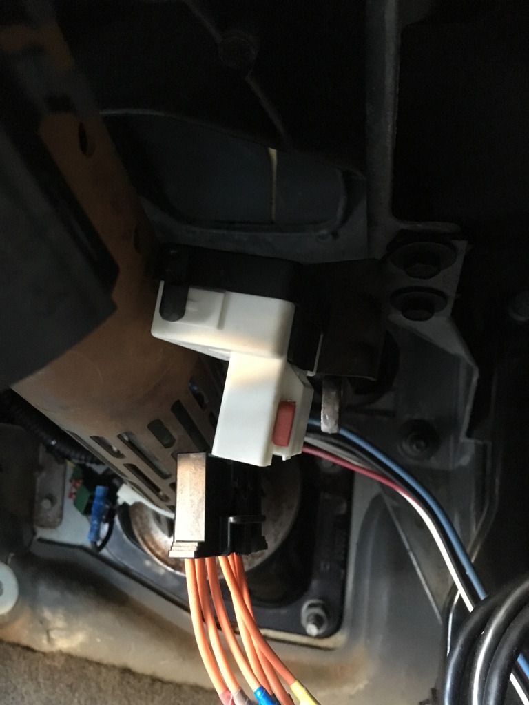

It has a safety clip, so just pull that out first. This is so that your brake lights don't stay on constantly while the pedals are out. You do not need to remove the switch completely like the FSM says. This is good in my opinion, because the switch says not to re install it. Not sure how critical that is, but there is no need to pull it completely out. If you are able to put everything back together right away you wouldn't even need to unplug the switch. Next, you'll want to remove the E clip from the passenger side of the pedal pivot rod/pin. It looks like this.

Some extra pics for you all.

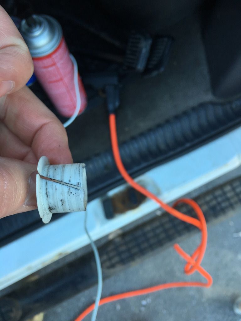

The worst looking of the bushings. Slightly deformed.
Before you start, you may want to order all six new bushings. The are about $4 a piece and you will need six. The FSM is a little confusing and kinda makes it look like you only need 4, but you need 6. The part number is 0429 4639, and they are all the same. You may also want to order new spring clips and E clips just in case. I don't know the part number for those yet, but I will try to remember to update this when I get them.
