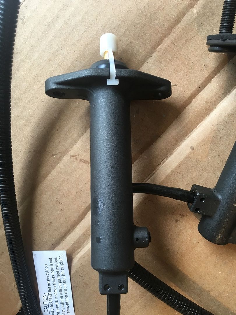

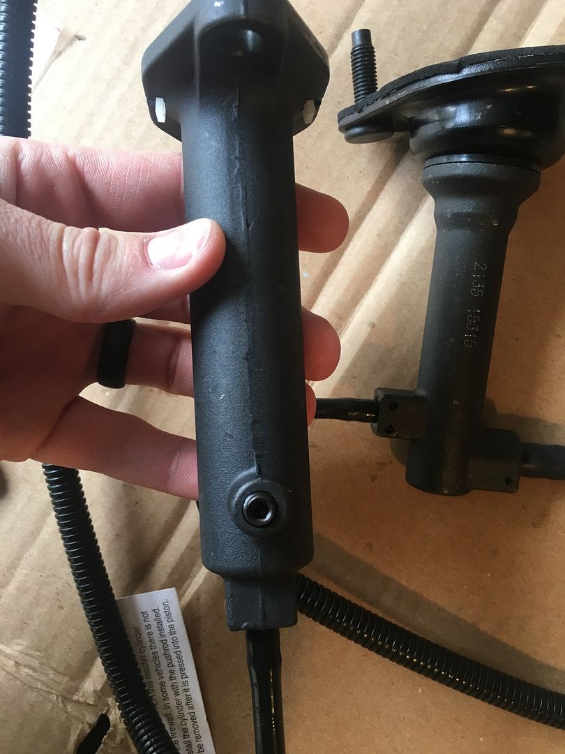

hey guys. I just picked up the master and slave assembled from autozone and WOW! The master and slave are made from cast aluminum, not plastic! And, the slave has a BLEEDER SCREW!!!!  I will post comparison pics later but overall this thing looks way better than napa's. My only questions right now are, should the bleeder screw face up or down? And, how do you bleed a clutch that has a bleeder screw??
Its hard to force air to go down so if its possible to set it facing up.....

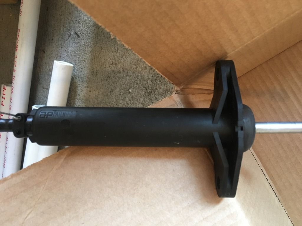

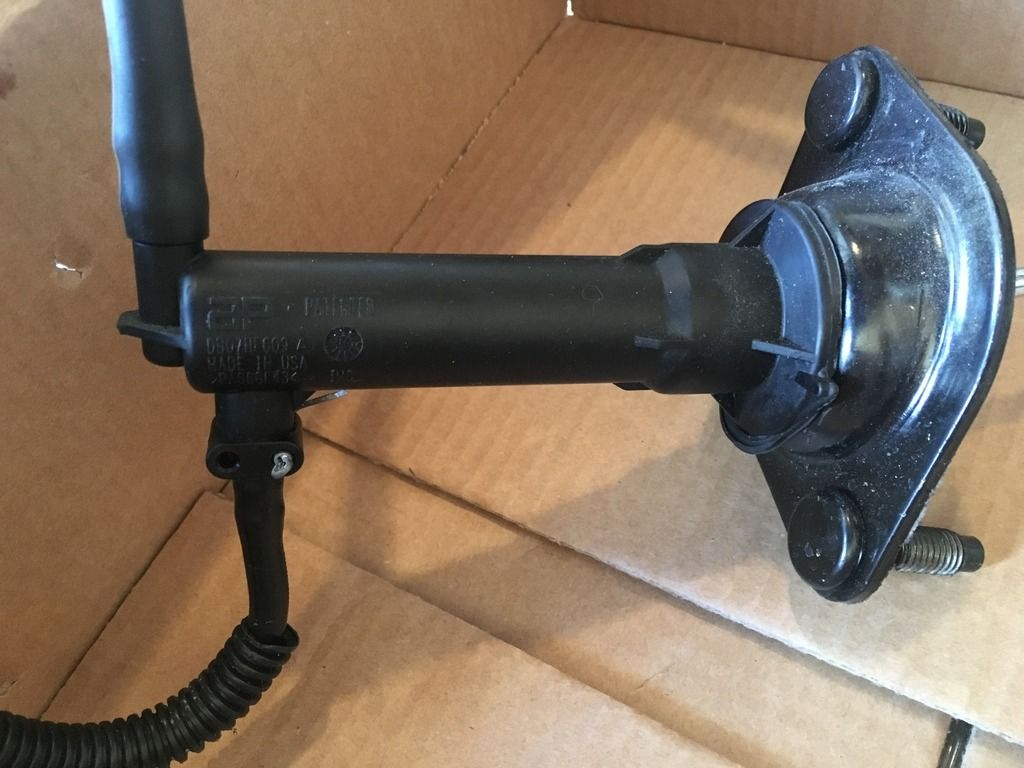

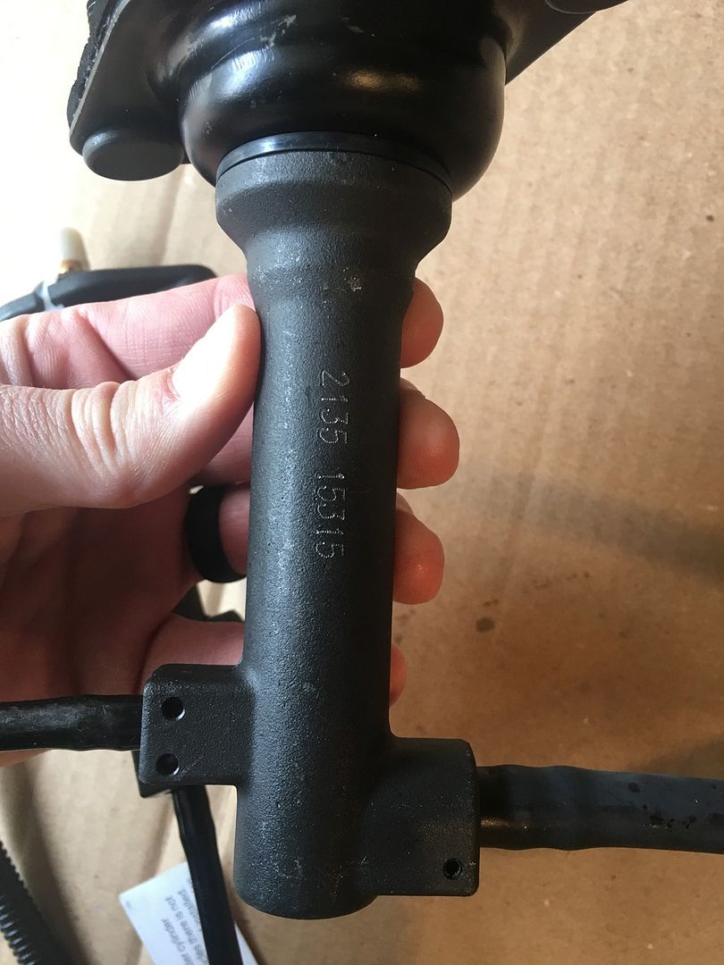

Hey everyone,
I got lucky for once! My problem was caused by the hydraulics! So far the new set from auto zone seems to be working great. I like the feel of the pedal a lot better too. I also have a little free play at the top now too which I am very happy with. Below are the pictures of the new slave and master from auto zone. I apologize for not thinking ahead enough to take a side by side comparison. At least you can see the construction and the bleeder screw. Also, just to be clear, I am not doing this to put Napa down at all. In general I prefer to deal with them over places like auto zone and advance auto parts. However, there are some instances where I like auto zone better for their parts or their polices. This is one case where I think you get a better product and a better warranty from auto zone. However, I do have to give Napa credit for making at least there master cylinder in the USA. I didn't see a stamp on the one from auto zone, but the box said made in china. While that disappointed me a little bit, I am over all happier with auto zone for this part. Time will tell how it holds up I guess.
Master from auto zone
Slave from auto zone
Master from Napa
Slave from Napa
