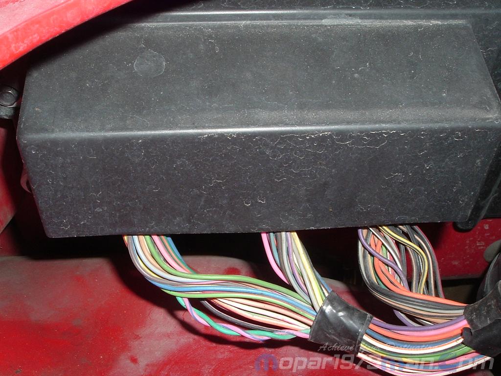

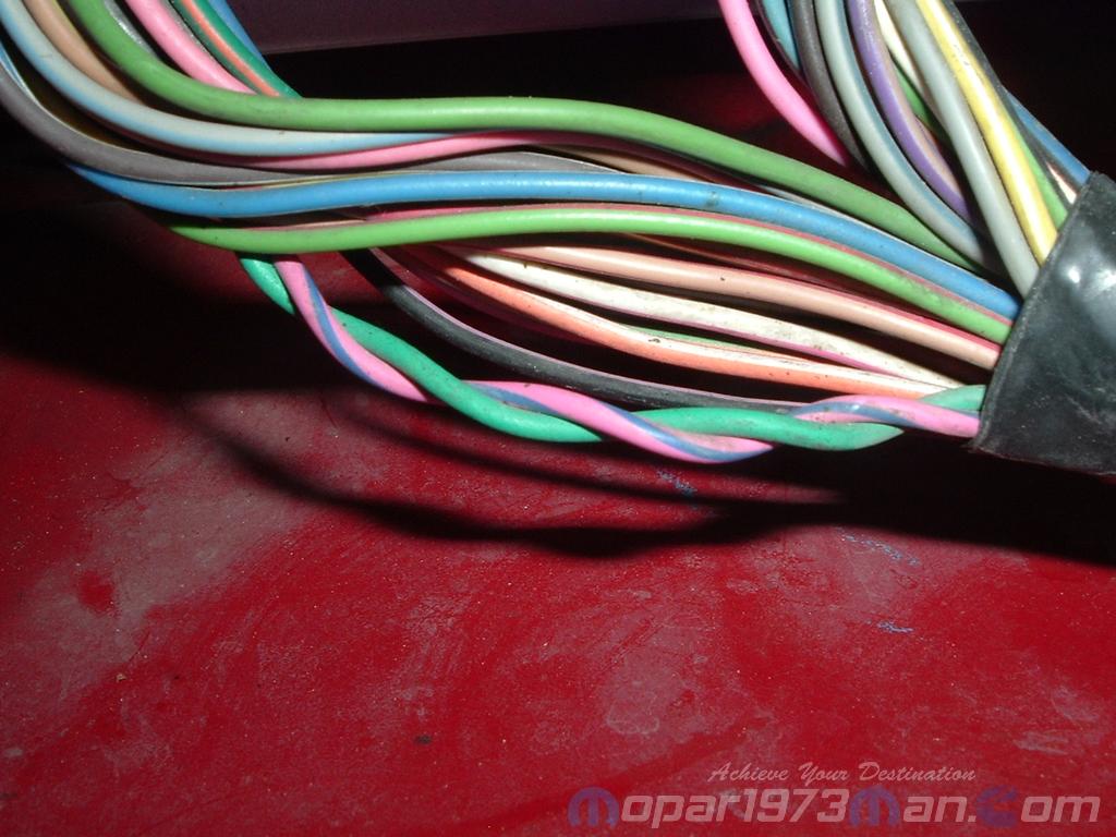

    The two wires (sometimes referred to as the “twisted pair”) that comprise the CCD data bus are the D1 circuit [Bus (+)], and the D2 circuit [Bus (–)]. The "D" in D1 and D2 identify these as diagnostic circuits. Transmission and receipt of binary messages on the CCD data bus are accomplished by cycling the voltage differential between the Bus (+) and Bus (–) circuits.
    The two data bus wires are twisted together in order to shield the wires from the effects of any Electro-Magnetic Interference (EMI) from switched voltage sources. An induced EMI voltage can be generated in any wire by a nearby switched voltage or switched ground circuit. By twisting the data bus wires together, the induced voltage spike (either up or down) affects both wires equally. Since both wires are affected equally, a voltage differential still exists between the Bus (+) and Bus (–) circuits, and the data bus messages can still be broadcast or received. The correct specification for data bus wire twisting is one turn for every 44.45 millimeters (1 3⁄4 inches) of wire.

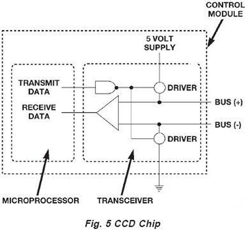

    In order for an electronic control module to communicate with the CCD data bus, it must have a CCD chip (Fig. 5). The CCD chip contains a differential transmitter/receiver (or transceiver), which is used to send and receive messages. Each module is wired in parallel to the data bus through its CCD chip.
    The differential transceiver sends messages by using two current drivers: one current source driver, and one current sink driver. The current drivers are matched and allow 0.006 ampere to flow through the data bus circuits. When the transceiver drivers are turned On, the Bus (+) voltage increases slightly, and the Bus (–) voltage decreases slightly. By cycling the drivers On and Off, the CCD chip causes the voltage on the data bus circuit to fluctuate to reflect the message.
    Once a message is broadcast over the CCD data bus, all electronic control modules on the data bus have the ability to receive it through their CCD chip. Reception of CCDmessages is also carried out by the transceiver in the CCDchip. The transceiver monitors the voltage on the data bus for any fluctuations. When data bus voltage fluctuations are detected, they are interpreted by the transceiver as binary messages and sent to the electronic control module’s microprocessor.

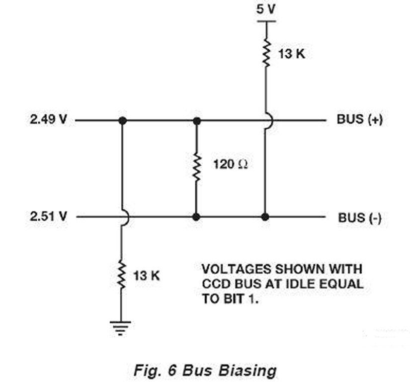

    The power supplied to the data bus is known as bus biasing. Bus bias is provided through a series circuit. To properly bias the data bus circuits, a 5 volt supply is provided through a 13 kilohm resistor to the Bus (–) circuit (Fig. 6). Voltage from the Bus (–) circuit flows through a 120 ohm termination resistor to the Bus (+) circuit. The Bus (+) circuit is grounded through another 13 kilohm resistor. While at least one termination resistor is required for the system to operate, most Chrysler systems use two. The second termination resistor serves as a backup (Fig. 7). The termination resistor provides a path for the bus bias voltage. Without a termination point, voltage biasing would not occur. Voltage would go to 5 volts on one bus wire and 0 volts on the other bus wire. The voltage drop through the termination resistor creates 2.51 volts on Bus (–), and 2.49 volts on Bus (+). The voltage difference between the two circuits is 0.02 volts. When the data bus voltage differential is a steady 0.02 volts, the CCD system is considered “idle.” When no input is received from any module and the ignition switch is in the Off position for a pre-programmed length of time, the bus data becomes inactive or enters the ”sleep mode.” Electronic control modules that provide bus bias can be programmed to ”wake up” the data bus and become active upon receiving any predetermined input or when the ignition switch is turned to the On position.

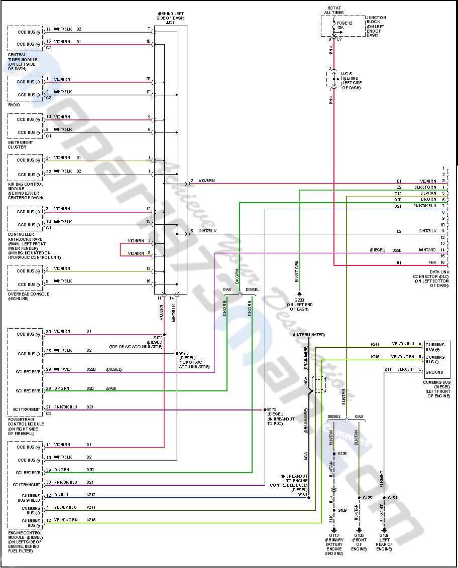

Basically in a nuts shell the CCD lines (pair) should have 2.49 volts and 2.51 volts at idle communications. So if one or both lines are shorted to ground, 5V or 12V then the entire network fails. So check this first you've got the wiring diagram already and it shows the pins for the CCD network in the OBDII socket.
Common spot to look is aftermarket stereo installs gone wrong where the CCD network is exposed to ground. Another is a failed module that is shorting out the network. Way to test for that is systematically remove each module one at a time by unplugging and seeing if the CCD network returns.

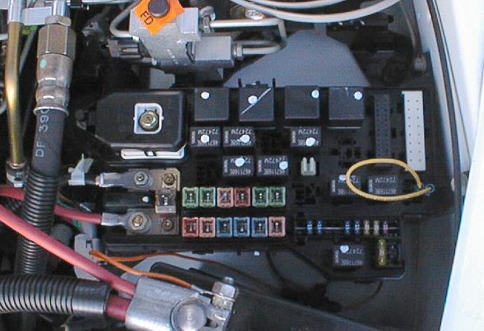

I finally got a chance to figure out my no bus dash problem, and turns out the black and white plug into the PDC was loose, cant seem to get it to tight but tight enough to start working again, Anybody got any fixes for that, like some sort of thread sealer or something?
Plastic clips broken?  Is there a way to get a ziptie around the plug or is it in the firewall?
big plug on top left of pdc, threads act like they strip out or something when snug
