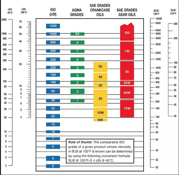

22 hours ago, Mopar1973Man said:
Because it's much thicker gear lube compared to ATF that comes factory filled in the G56.
Yes it's thicker than ATF, but ATF is only the DC factory fill. The OEM (MB) spec is a GL-4 fluid. There are 4 primary recommendations which range from  SAE 50 to 80w gear lube, 75w-80 gear lube, or 75w-90 gear lube. So it shouldn't be too thick.
The Delvac 50 just doesn't seem to work well with it, among others.
ATF has similar viscosity to 80wt gear lube.
