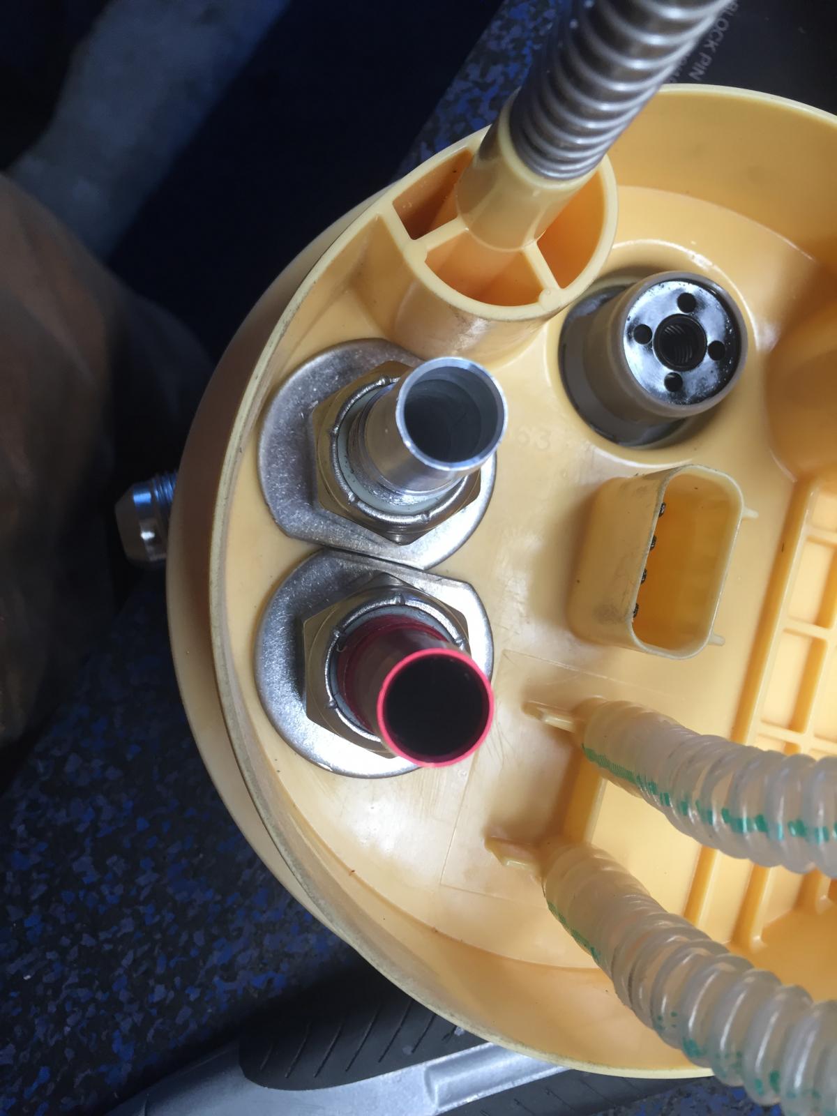

Definitely use a step drill, keeps the plastic from splintering. If you’re only adding the pickup then only one hole is necessary but I added two in mine.
4F53B357-3AFA-4949-AC1E-9CE5504579FA.jpeg.18700c9c5a58d133ea9033595983fabd.jpeg89EC0DEA-BB5A-4029-9681-1D6BB5FF75F2.jpeg.43fc6e44a0ecdc91fd696fbc190dfa75.jpegC567CDD6-8B3A-4988-951B-D175EFD8C35A.jpeg.28e042c3bc302e16afa1992ed329cc49.jpeg
Thanks! Very nice.  I appreciate it.
No question about there ever being fuel in that basket!!
And where did you get the Red and Silver Bulkhead fittings and adaptors please?
