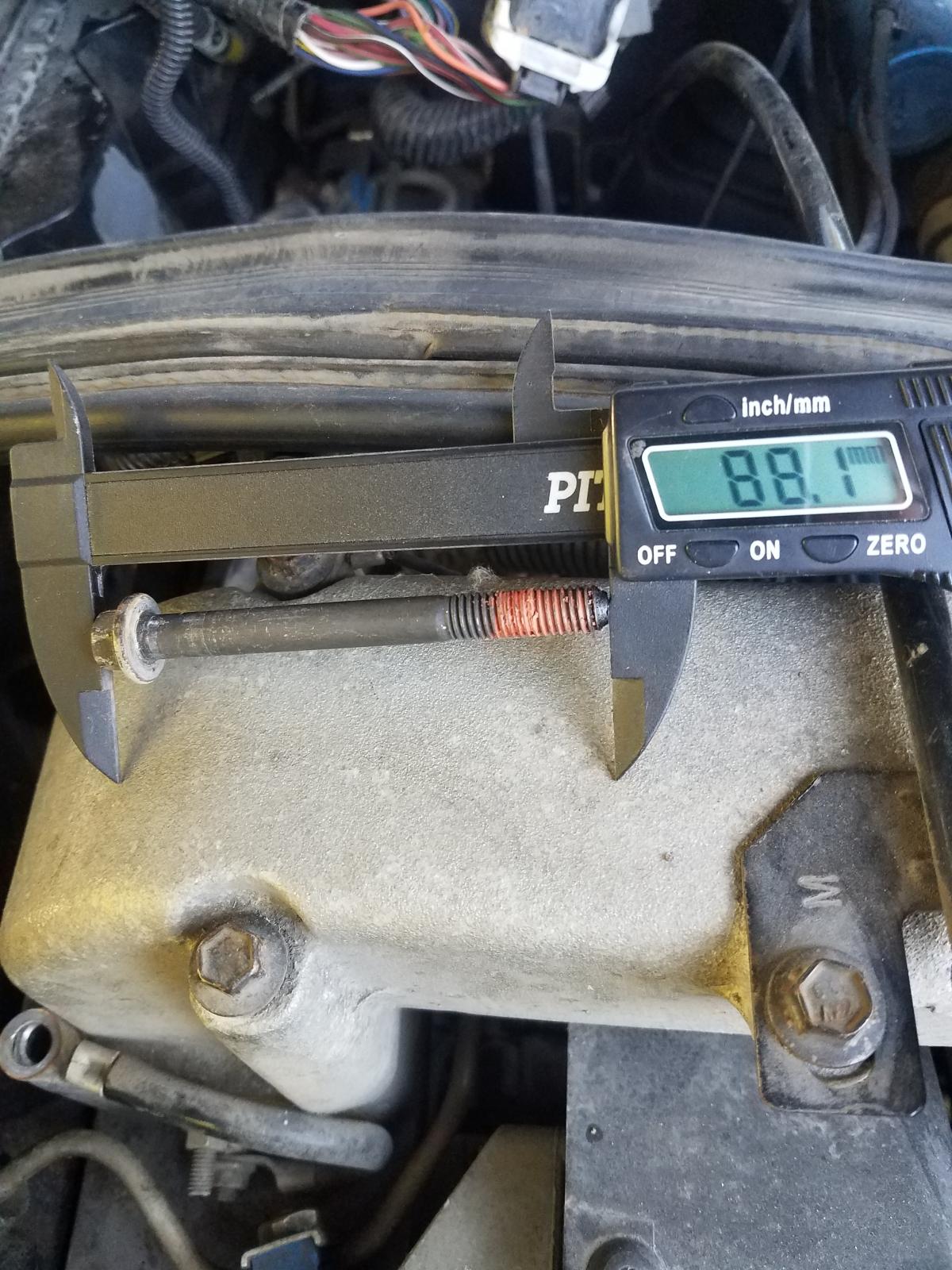

Help Please.  I have to change out the Air Horn and add heater grid to smog the truck.  Found a loaner Air horn and Heater grid but no bolts.  I have to get the grid.  I was wondering if someone knows the correct bolt length.  I went to ACE and the longest that they have just stick out through the Air Horn.  They are 8mm x 1.25 Pitch X   ___  how long?

If I got right bolt you want.  See hole it came out of cloest to radiator and see mm on caliper?

Is that the Air inlet horn?  I bought a 100 MM at Ace and it  just stuck through the air horn it's self.
Oh I see from your picture that the short one.  How long is the Long one???

I get 6 1/4 (longer than my calipers)
does not include head of bolt or built in washer head thing.  Just the part that goes inside.20180904_182404.jpg.253e781a00d230f91a547e59c39a6cdc.jpg

6 1/4  Thanks!!   Fastenal opens at 8:00
