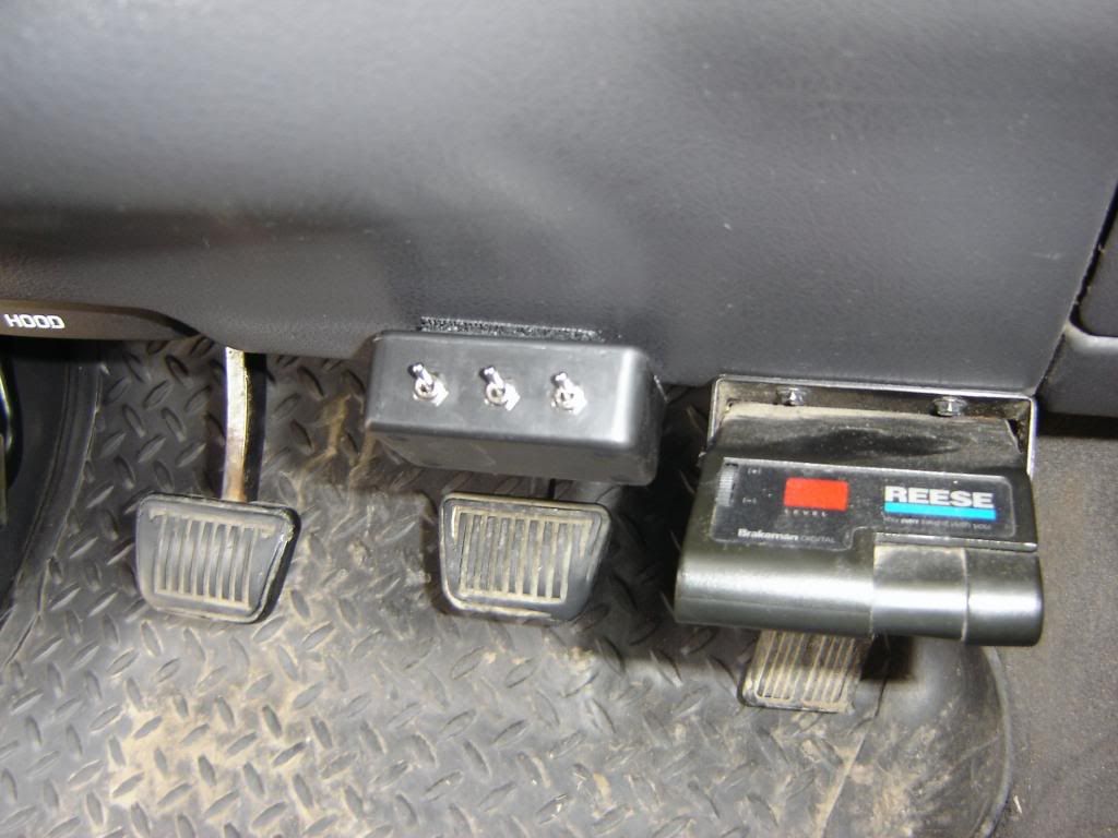

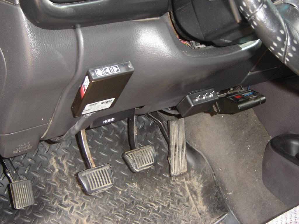

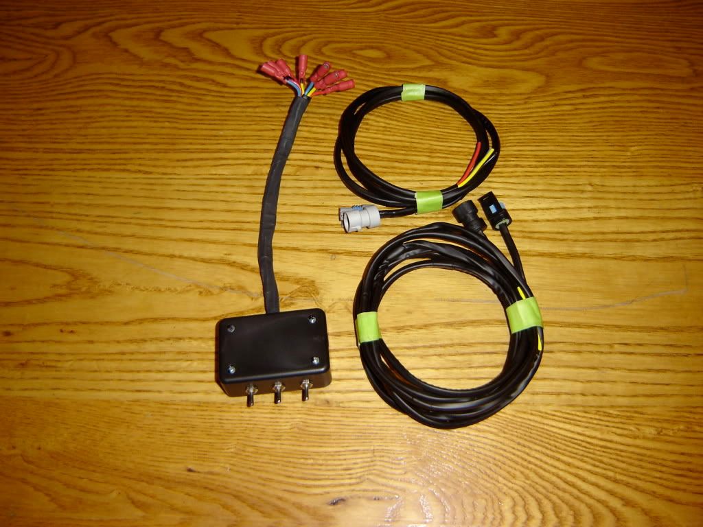

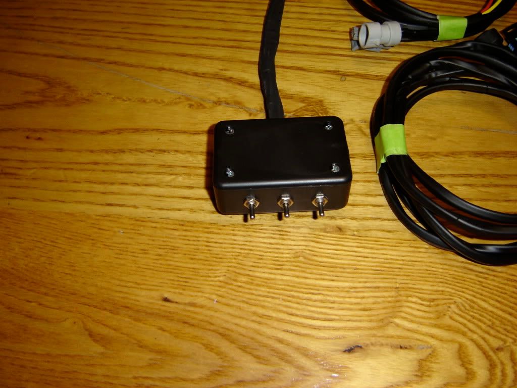

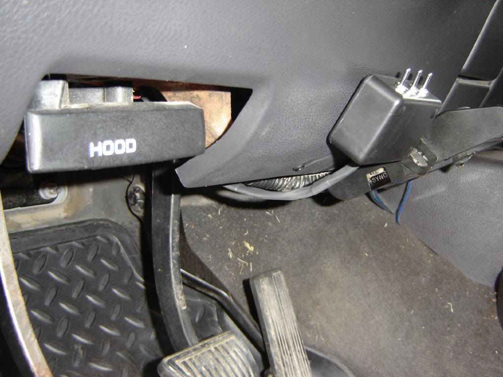

In case you don't understand what I mean here is my set-up:
Posted Image
Posted Image
Thanks,
Winslow

Yeah I read "box mounted under the dash that contains everything" and figured that must have been the setup you were using. Very clean :thumbup2:

Mine inside the cab:
Posted Image
Posted Image
Posted Image
Thanks,
Winslow
