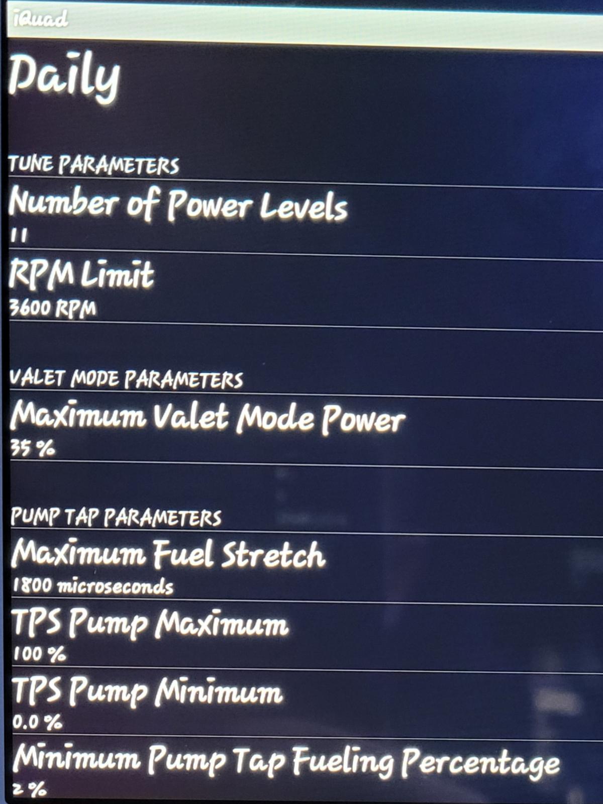

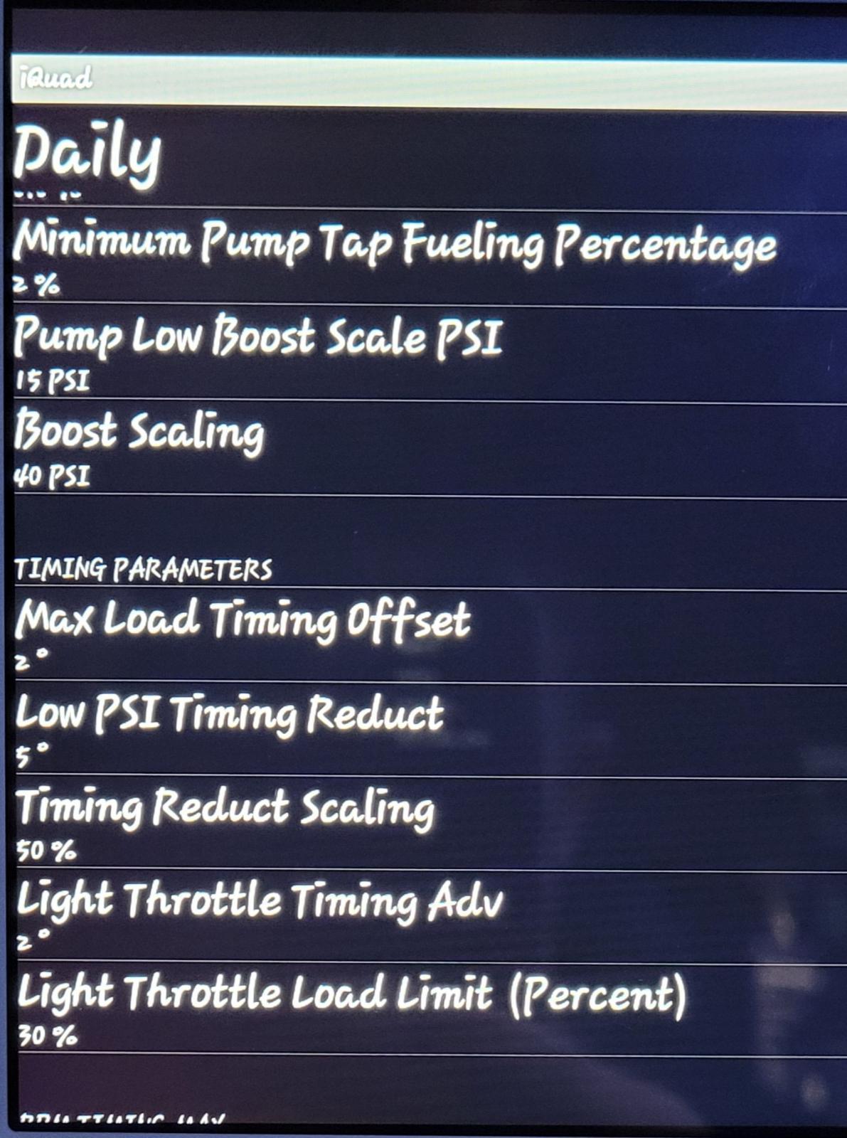

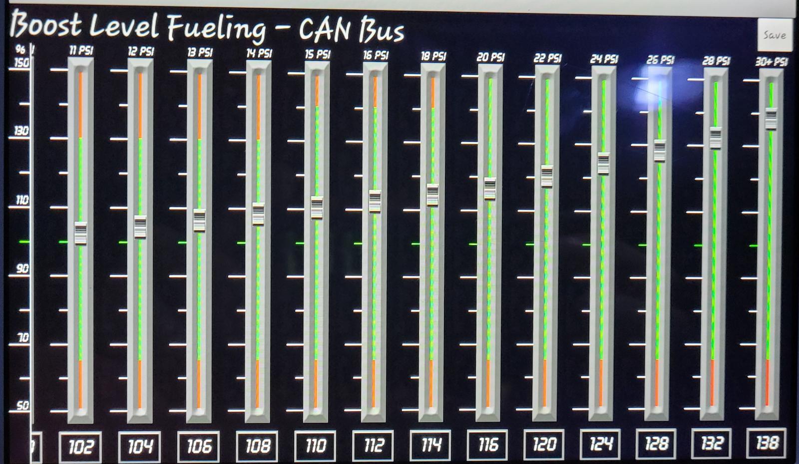

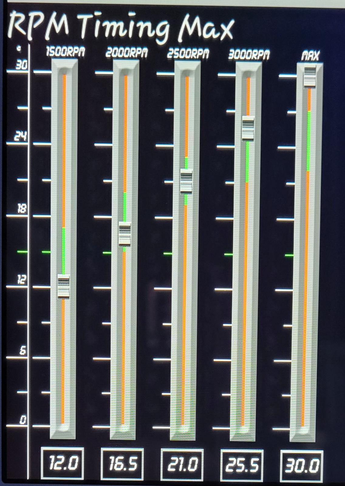

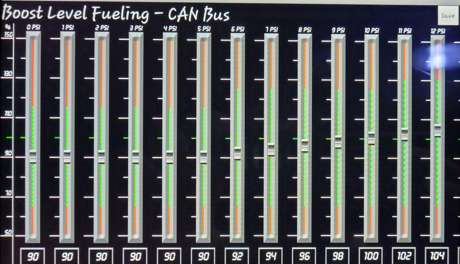

So here's those pics/tune. Pretty much exactly what everyone on here has suggested to use or try.
I still think I need more fuel so I might add +2 to everything and see what happens. I'll prolly post this in my other thread too.

With my 7x10s and 62x67x12 my fuel starts at 76 it's at 100 by 10 psi. Maybe try starting at 80 and ramp up by 3 till 10 psi then ramp by 4 till the end just to see what happens.
Not really sure what you want to achieve and how your turbo spools, starting at 90 do you have much smoke on take off? When is the turbo spulling up and cleaning things up?

Yea pretty much no smoke at all really, for what I have I figured I'd have alot of smoke to try and clean up. I guess I really don't know what I need to shoot for? And at this point prolly still don't know how to lol.

I removed 2* from everything
1500 @ 10, 2000 @ 15, 2500 @ 19, 3000 @ 23, max @ 27
and 100 from 0-10 then +2 till 15 then +4 up to 30

I literally just got home with it. Hard to tell with 5 cylinders lol the timing change made it less peppy I think. I noticed a bit of smoke but nothing even close to pre injector/quad, I also didn't want to really push it cause who knows what could happen with this Mish mash of things going on.
