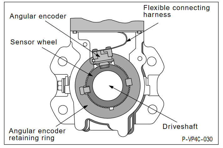

There is an angular encoder inside the VP44.  It provides many features, but one feature is a redundant camshaft position sensor.  This is probably why the engine ran for 15 seconds during your test.  I am guessing that when the VP44 is reconnected, the ECM is picking up the signal from the angular encoder and consequently turns on the lift pump.
- John
That is incredible… Interesting. Thank you for sharing that.
