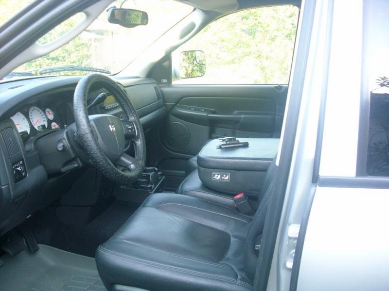

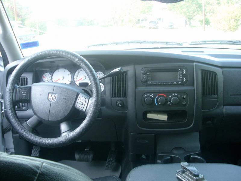

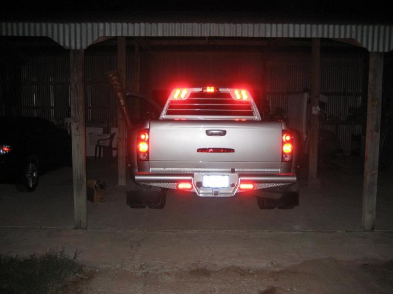

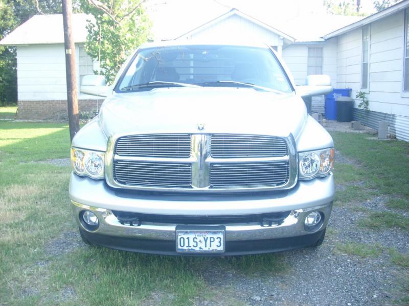

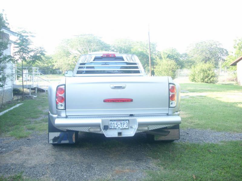

When I set out to buy a truck I didnt plan on finding what I did. She is sharp, been garage kept sence it was new in 05. The guy was totally a neat freak I mean not even a speck of dirt anywhere. His wife came back from the grocery store while we where looking at the truck and she unloads the groceries and starts cleaning the Lincoln navigator :cookoo: all that was there was groceries it's like she just hauled a load of wood or something.Her Lincoln was a 98 and it looked like a 2010.Anyway she has 38k on the clock, 6k miles a year:lmao: can you see me welding out of this truck:clap: I gave 24k and it list for 27, I belive it could bring 29 just on how clean it is and low miles. Anyway it's a auto trans, so who do I get a valve body from and do I need tourqe converter? What is this I hear about a solenoid inside the trans that needs to be replaced? And what do I run for air filter looks a little tight for BHAF. Does this exhaust have a catalytic converter or is it a resonator. It needs new batts, is there anything I need to be cautious about taking these out? I mean just breaking the power supply. And what is your thoughts on two stroke oil?I hammered on it a little and it rolls a little blackish/brown smoke, is this normal? I had to clean the rear fender after about two hunderd miles it wasnt bad just a little dirty.
Yes it has a Cat, in 04.5 all CTD Rams got a 4" exhaust with a Cat.

Is that a Nav radio?
Don
Yes it has Navigation, but it only has the east coast CD the central and west coast he must have kept.And as far as neat freak goes I have him beat at the moment :lol: I dont let the dust settle on it, got a towel in hand keeping it clean.As far as valve body a tourqe converter go, thats just what I have heard. I like what you have to say it makes me fill like maybe it will last.And how do I disable the key dinger? That drives me nuts.So does anyone run 2 stroke with these trucks, reason I ask is I have ran it for about 2 years in my 2nd gen with good results.Noise baffle, I guess I will go look again. In case I dont see it , where's it located?Thanks Joe
