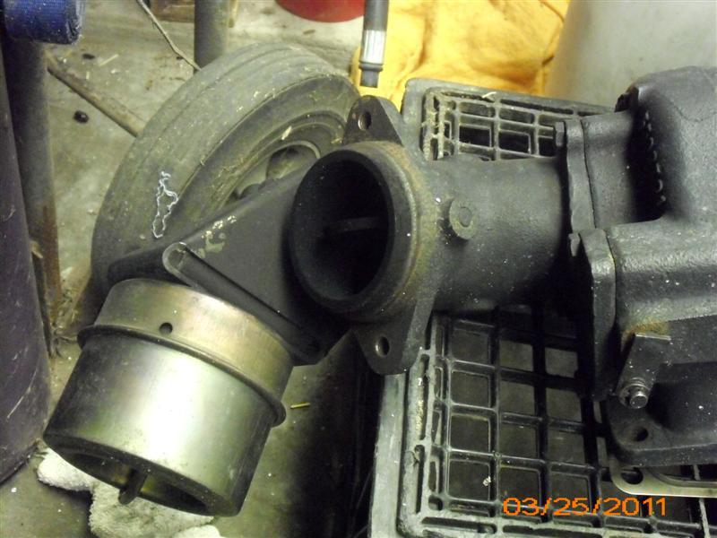

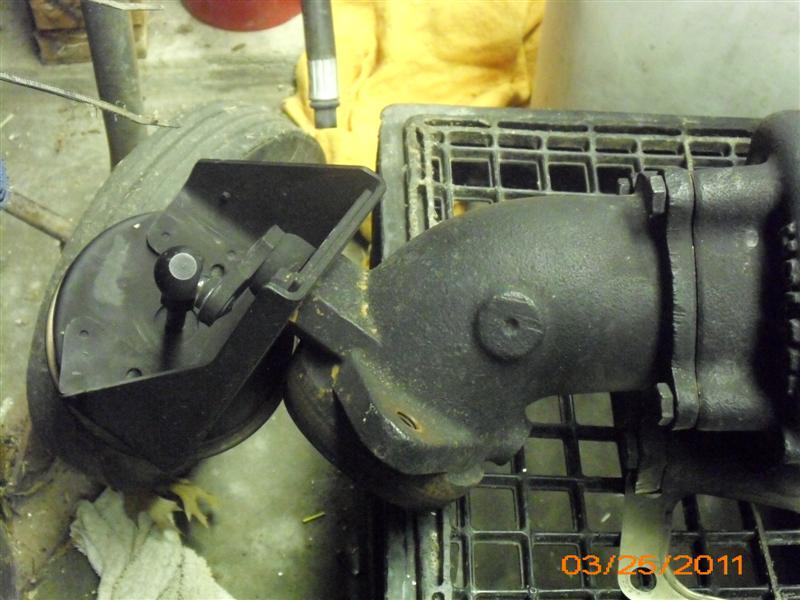

I'm looking at a jacob brake off a 2001 5 spd with the HX35. Wondering if this will fit my 02 6 spd , and also wanted you guys to look at the pics here and tell me if it looks like it's everything here:shrug:. Seller says it doesn't have a switch with it for inside the cab because he's using it for lights now, so wondering if i can just use a normal toggle switch..and if there's anything else that doesn't look like it's there. He said something about a 4 wire mini harness that runs into the cab and connects to the factory harness ? Any ideas on that one. Also, I have the 4" MBRP turbo back which appears to be 3 1/2 " at the flange then expands out right away to the 4 " hooked to my stock turbo , the pic of this doesn't look like alot of room between the flange and the canister on the brake for the pipe to fit on...look normal? post-10164-138698178795_thumb.jpg

it looks like it would bolt up to my 02. you would need the do some measuring ot be sure your exhaust will bolt up to the brake properly. there shoud be a wiring harnes so you can tie it into the trucks wiring. my banks tied into several things. i dont remeber it all now. mine operates on a lighted toggle switch. same as any toggle switch you can get at the parts store, lighted or not. i would not know wether it was all there even if it was in front of me. you might be able to look it up on line and see what the kit came with.
Same as what I've got... But it looks like your missing the dash switch... Yes you can wire in your own toggle switch I done the same thing with my truck but I'm going to have to take a peek at which wires I used.
My switch is on the gear shift. It looks like the old 2 speed rear end switch. Up on down off. That way it is always at hand. == GOOD LUCK ==
