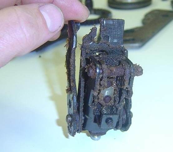

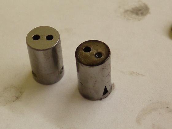

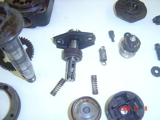

During the time of producing BioDiesel the fuel must be washed with water to remove the gycerin from the fuel. So alot of home brewers get a sloppy about get the water drained of and manufactures also in the pass had issues with quality control. So Mopar and Cummins set the limit of 20% because below that level it mostly petroleum diesel and the chances of get large amount of water is thinned down.
I'm not a pro of making Bio but listened to plenty of tales of production and read up on Dodge/Cummins specs of using it.
Here is what happens if you don't wash the fuel properly...
Posted Image
Posted Image
Posted Image
