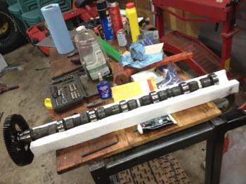

Stage 2 Colt should be here tomorrow. Got all the needed replacements for my selection of leaking seals from Regional International night before last. I may end up with a haul Saturday instead of getting it done when I first planned to but either way I'm excited!I was really tempted to do RV 275s at the same time with that cheap set for sale here, but I decided to see how much difference the cam alone is going to make first. Right now the '02 isb205 has a b215 cam in it along with the p7100. details linked in my sig.

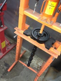

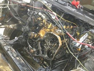

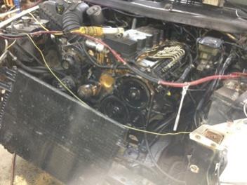

Got the swap done and put about 35 miles on it. I took a little timing out too. I think I was at 16-16.5 before, now I'm at about 14.5 if I remember right - and if 3* is the proper correction for the pop pressure difference (stock ISB injectors fed by a P7100). Feels way slower off the line, not sure if I like that. Its still all there if i put my foot in it, just slower than it was. Starts a million times easier though. 15-15.5 is probably the sweet spot for my future reference. Got on it good coming back home once and I can still get it hot, but I think it's more reasonable now. I didn't bury the pyro, which I think I could before if I tried (1600). Need to get a load behind it and pull US15 N to really know if it helped me as much as I hope. Found and fixed a few other issues while I was in it. Think I have a couple weeping injector lines still to deal with, and I definitely have a big bubble in the heater core. Brr!! Fixed my shutdown solenoid bracket again for the third and hopefully for last time. All my timing cover bolts had been loose, that was probably most of the oil leak. All locktited this time around. Though I'd done that before but ???I had the motor pretty completely stripped since I changed the tappet cover gasket. Both fuel pumps off, etc... Took probably 15-16 hours total wrench time. Noon to midnight yesterday and 11-5 today with a couple food breaks. Big job...
Guess I got too distracted by the light at the end of the tunnel to get any pics of the nice shiny Colt Cams badged retainer, or anything else reassembly related.
