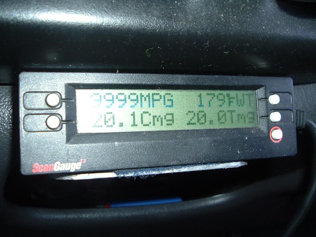

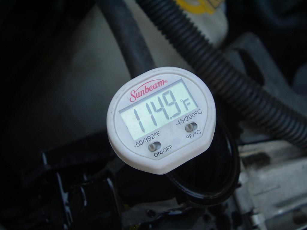

Even with full temp 190*F my cap side will measure much lower. post-2-138698195522_thumb.jpg As for the up/down is a sign of sticky thermostat which may or may not get better with time. Some get worse.

:omg: Mine never got that hot so I guess I'm OK. Looks like your only getting about 10 volts too? Thanks for taking the time to take those pics for me! I feel better now. I guess the rock solid 190 I was seeing is something all wish for but only a few are rewarded with. :cry::cry:Don't say that! I guess I'd better start searching for heater core replacement threads!
:lmao::lmao2: The engine not even running for most of it. What I did was plug in different resistors into the ECT plug to show the different digital / analog temps. So people can understand what the analog gauge is tell you. As long as the need is in between both lower and upper tick marks your good. Heater core article... http://articles.mopar1973man.com/2nd-generation-24v-dodge-cummins/27-hvac-heating-ventalation-and-air-conditioning/57-air-conditioning-evaporator-core-heater-core-replacement
