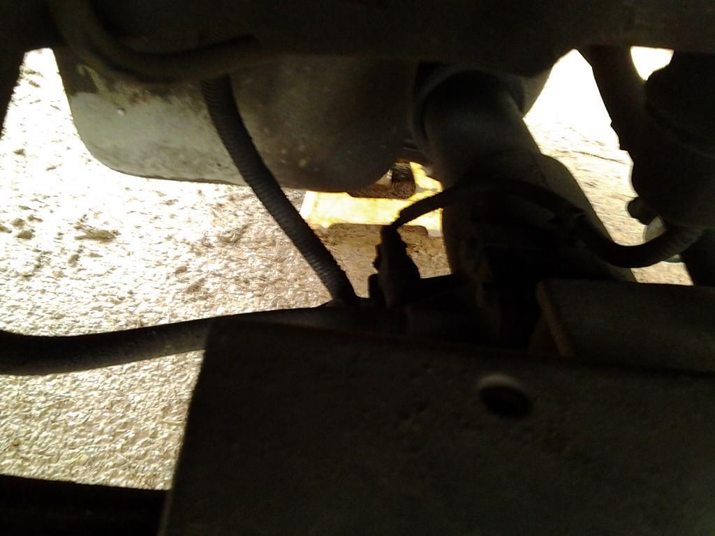

Hmm, this brings up a good question...Where are these ABS sensors located? I have an ABS light on the dash, but I have yet to see where the sensors are located, etc. I do not remember ever having to disconnect anything of the sort on the rear or front ends.Pics?
I believe that the one Mike is showing is for 2000 or 2001. Mine does not have a hook up like this either. I think it is on the right side of the axle. There is a connection there with some electrical wires there. Bothe HeX and I have 99's. :2cents:

I believe the ABS sensor is the wires closest to the axle. It would be pointing towards the l. tire. The other wires plug in from the back side closest to the r. tire. Hope this helps, Mike.post-198-138698198159_thumb.jpg
