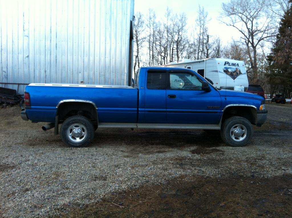

Got my levelling kit and air bags on :)
Got the 2" leveling kit for $90 used and the air bags for $150 used. Got it all on last weekend. With 20psi in the bags empty it rides way smoother than before. It's not sitting too high for the 265s in my opinion.

Looks good. I kind of wonder about the life your truck has had. By chance did the truck do a lot of heavy hauling in the past?
No, it hauled drums of chemicals to oilfield sites until it had 380,000kms on it. It never had a 5th wheel hitch until 4 years ago and hauled a horse trailer a few times. Still has the stock balljoints in it and front axle u joints are original too. It only needed the air bags cause once the 2" leveling kit was in a load made the rear sit lower than the front. Otherwise my 1500lb camper made the truck sit level in stock condition. I just wanted it higher, plus it rides nicer on air empty. Before it was rougher until it had weight in it. Now when I haul a load of bales thats 17,000lbs it won't squat at all.

Zukifreek, your truck looks great!!! I have installed on my truck, just what you did on yours, and it sits about the same.
