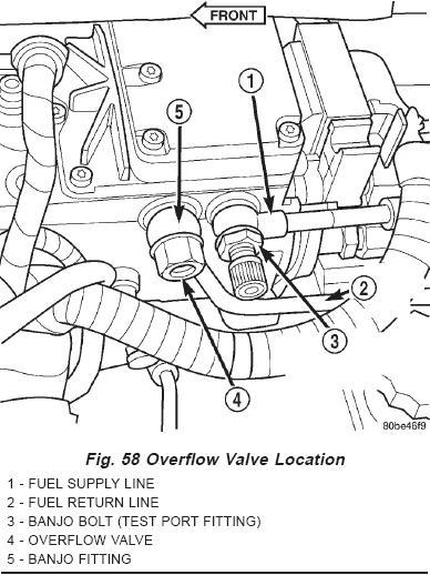

Thanks for the link Lone Watie. Does that piece replace the banjo bolt that is next to the VP's inlet port?
There are 2 banjo fittings at the front of the vp, one is the inlet, the other is the overflow valve, to which the return from the VP is attached. The one furthest most to the front is the overflow, the one aft of that, towards the rear, or right in the picture, of the truck is the inlet from your FASS/AirDog/Stock Filter,whichever you have. Here's a pic mopar man has posted in the articles section of the forum. The left of the pic is the front of the VP as looking at it from the left side of the engine compartment. Right side is to the rear of the truck. Hope this helps. And, to answer your question, yes, that piece replaces the banjo fitting in the pic. The only difference is the the fitting from vulcan (I believe Geno's has that part as well see this link http://www.genosgarage.com/BANJO-BOLT-TAPPED-985-09-59L-67L/productinfo/BF%2DLONG%2DTAPPED/) is extended so that it can be tapped for the 1/8" NPT for your FP gauge. I used the 3/8" line kit from vulcan to go from the stock filter to the VP inlet, and added that so I could attach my FP gauge line there as well. You should be good. Hopefully, if I'm wrong, others will chime in on this. Other than the FASS, our VPs should be the same. I'm a 1999 as well. By the way, Richard at Glacier Diesel, from whom I got my fuel boss, mentioned yesterday to me, as a side note, that the overflow valve has been known to cause erratic pressure readings when it starts getting weak. I don't know the internal make up of that overflow valve. Geno's sells that as well for something around $36 and is as easy to replace as the banjo fitting we're discussing. I'm going to order one from Geno's to have in the toolbox if needed. Here's a link for that as well http://www.genosgarage.com/BOSCH-VP44-FUEL-OVERFLOW-VALVE-985-02-24V/productinfo/1467445003/ post-10082-138698201465_thumb.jpg
in the above pic, I put my FP gauge's snubber bolt in #3 spot, on my 24v.
Is the overflow valve actually required? I have a tapped 14mm banjo bolt that I believe would fit(the overflow valve is larger than the 12mm fuel inlet). If I can't use that port, I'll just cut the FASS fuel line and install the t-fitting........
The overflow valve I'm referring to is not plumbed for anything other than over flow for the VP. When the pressure for the VP is too much the overflow valve opens and releases fuel back to the tank. It's not part of the inlet side of things, but the VP outlet. I wouldn't mess with it. I was just referring to it to show you where it is located in relation to the VP inlet connection, which is where my fitting with a needle valve going to my gauge is located. Sorry if I caused any confusion with this.Interesting about the 14mm threads. I had just assumed it would be 12mm like the inlet banjo. I just went and checked my spare overflow I have in my toolbox and sure enough mine is 14mm as well. Apologize for unintentionally misleading you on the size of that overflow. Still, it is not part of the inlet side of the VP though they are next to each other. If you plumb your gauge into there you'll be reading return pressure from the VP to the tank, and will not have overflow protection for the VP if you remove that valve. Hopefully someone can chime in here soon on this to either confirm or deny my understanding of the overflow valve.
