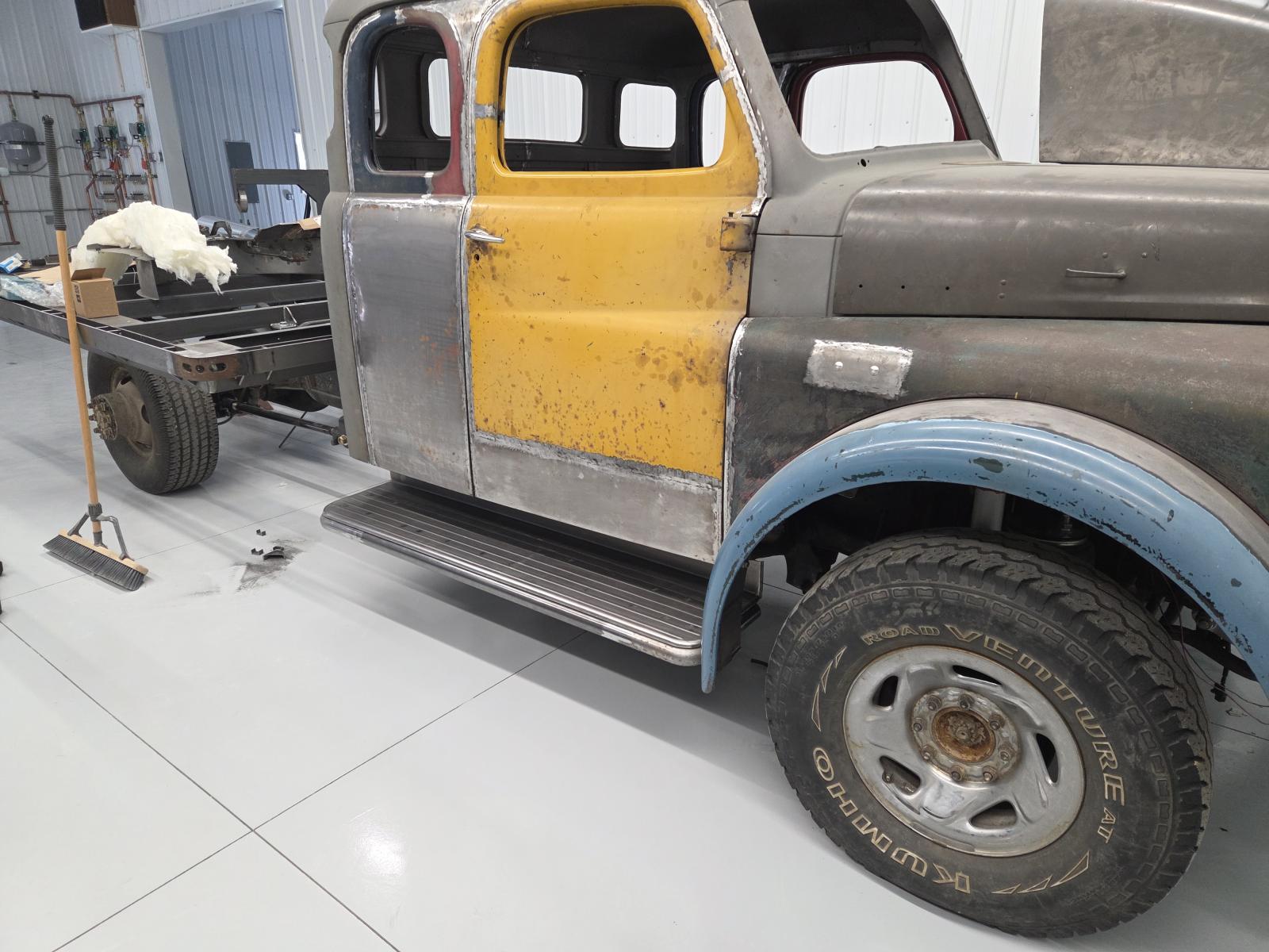

Running boards ready for dry fit. I know I have notch something for the cab mounts.
