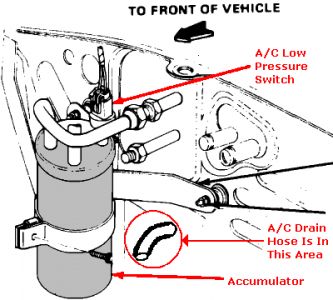

A vacuum  sounds like a good plan to me. I looked for the drain and wondered how I'd get a blow gun into the top to clear it out. I figured that I would not want any stuff getting pushed back into the HVAC unit. Just to be sure I'm looking at the right part, the drain is just behind the accumulator in the fire wall. Yes? Can the accumulator be removed from it's bracket and gently slid out of the way to gain access to the drain? My hands are fairly small but I doubt I can get much down there behind it.

You have the right area for the drain. It is a small rubber nipple sticking out close to the bottom edge just before the firewall folds under the truck.
