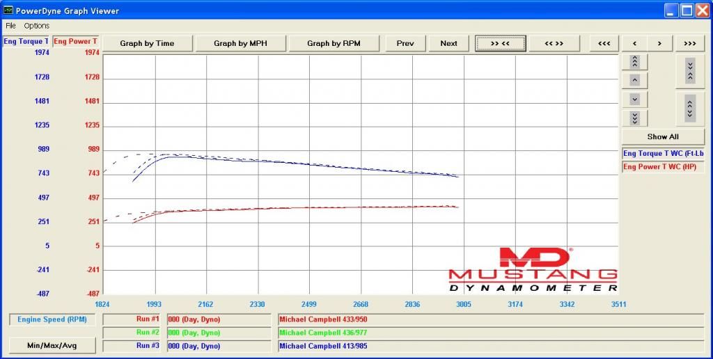

Well here is what I put down last weekend.
This was with the Smarty on 6 and the edge comp on 5x5. I basically make out the turbo and I'm now in the market for a replacement turbo... looking to hit somewhere between 550-600hp and about 1200ftlb of torque.
Mulcher you should have tried it without the smarty... Would have been interesting to see!
550-600 you'll probably need a 64mm and that's laggy. Go twins!
Most Mustang Dynos are load cells but can be used as inertia as well, did you do the runs loaded or just as inertia with no load and simply running up the drum uncorrected? Is your comp hot unlocked or not, Probably could have hit 450 and 1000 with comp alone on 5X4 which has always done better on my runs as well as a lot of others I have seen over the years.
My 02 was 560 hp fuel only with silver 62 BD 155 sticks and hot comp and II HRVP44 which only gained me 40 hp over regular SO pump. With this setup and injectables 600 would be easy, silver 62 was a fun turbo.
This Dyno was loaded and they did set the off set. I did do 2 other pulls with just the comp and the best group was what I posted with the smarty and comp :shrug: My comp isn't the hot unlocked version. The tech told me I probably wouldn't get much more HP out of the HE351 and 100hp sticks. He was saying that I was basically out of air flow.
