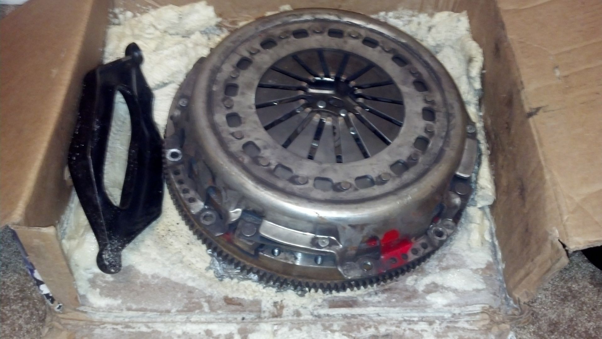

So I guess today was my lucky day!
Found a clutch for sale which the shop owner said had 4200 miles on it. I think it has considerably less because it doesn't even look broke in. Only missing part was the throw out bearing. The hydros went out and the owner said it didn't engage smooth enough for him so he put a napa clutch in it.
It's a SB DD3250-6, so I'll need to get an input shaft upgrade, piolet bearing (Just to be safe), a throwout bearing and some new bolts.  Best part is.... 480 bucks!

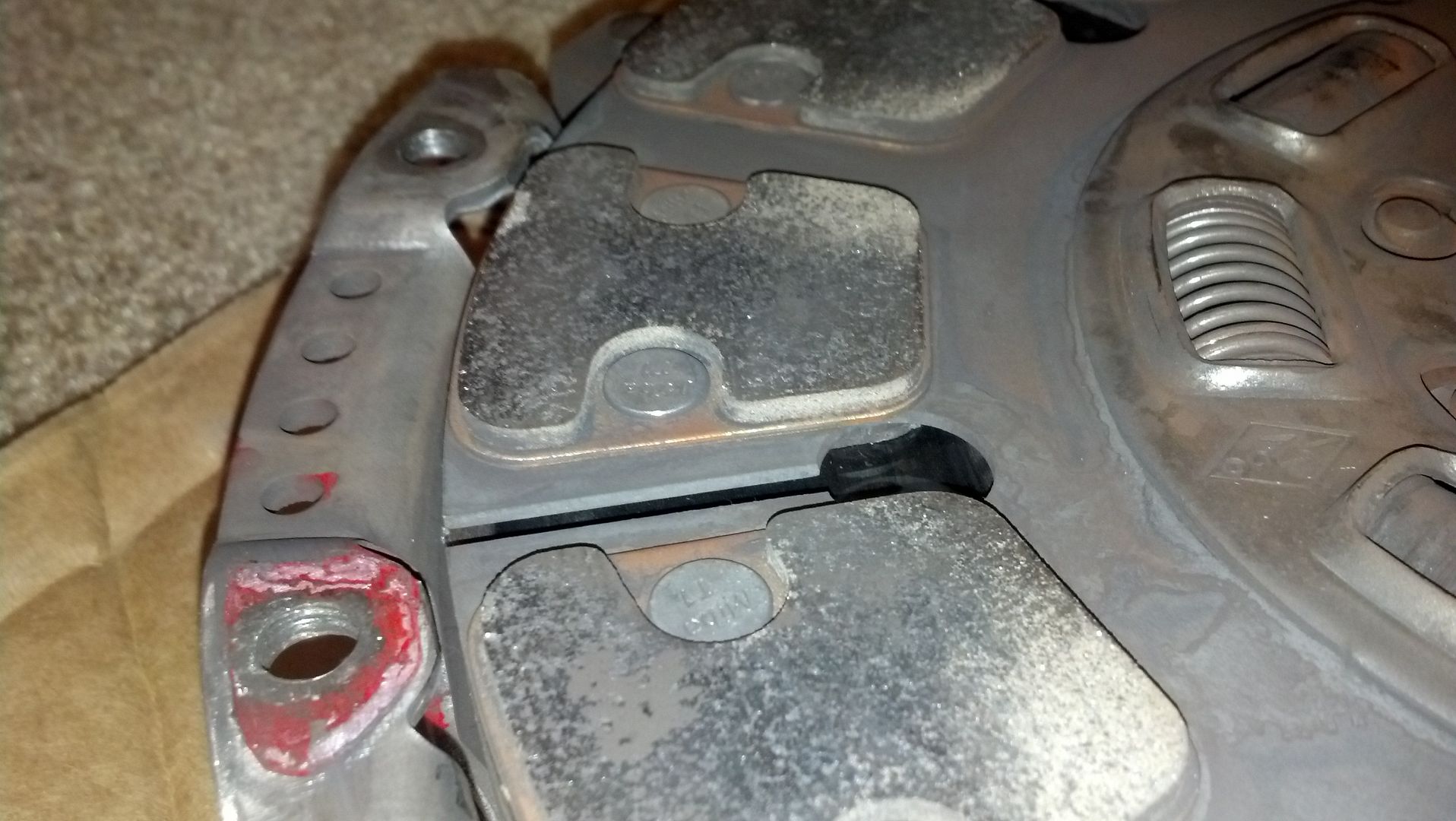

PP doesn't look broke in
Pucks look new

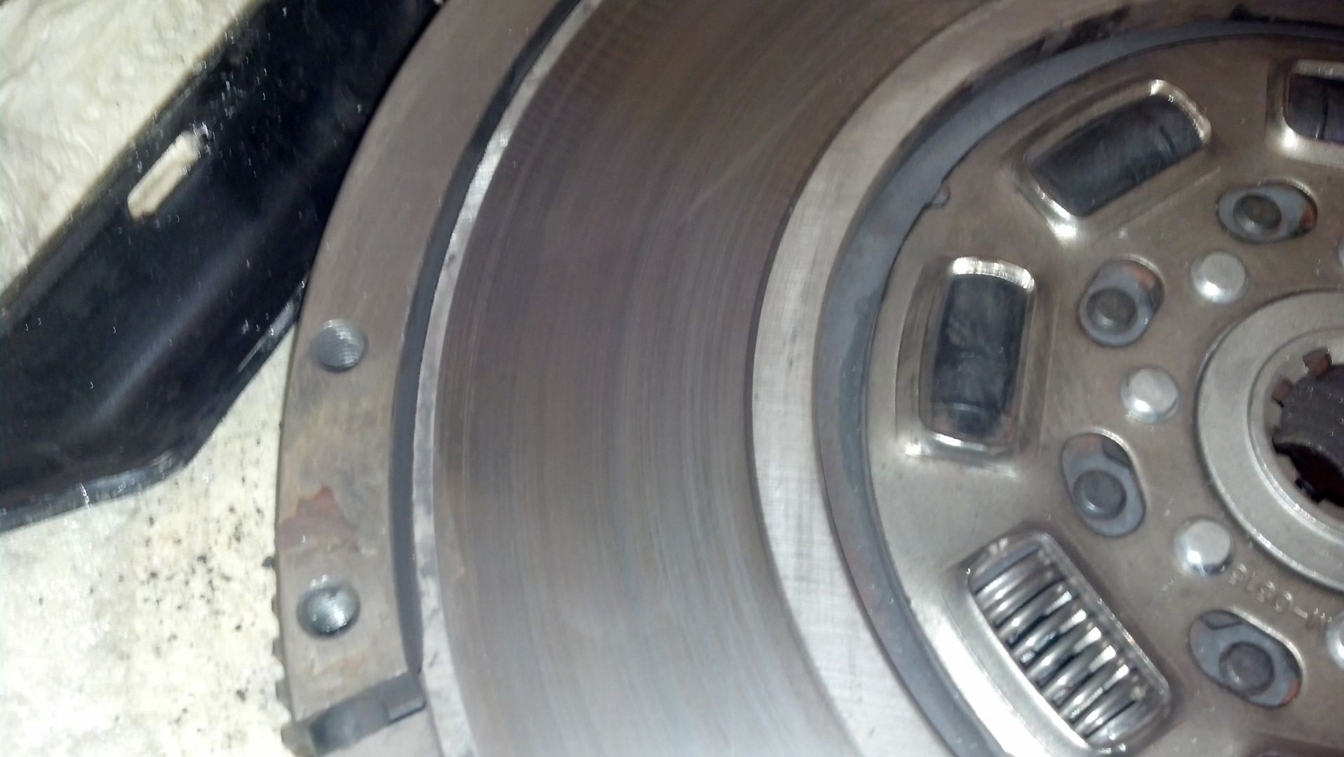

Flywheel doesn't look broke in

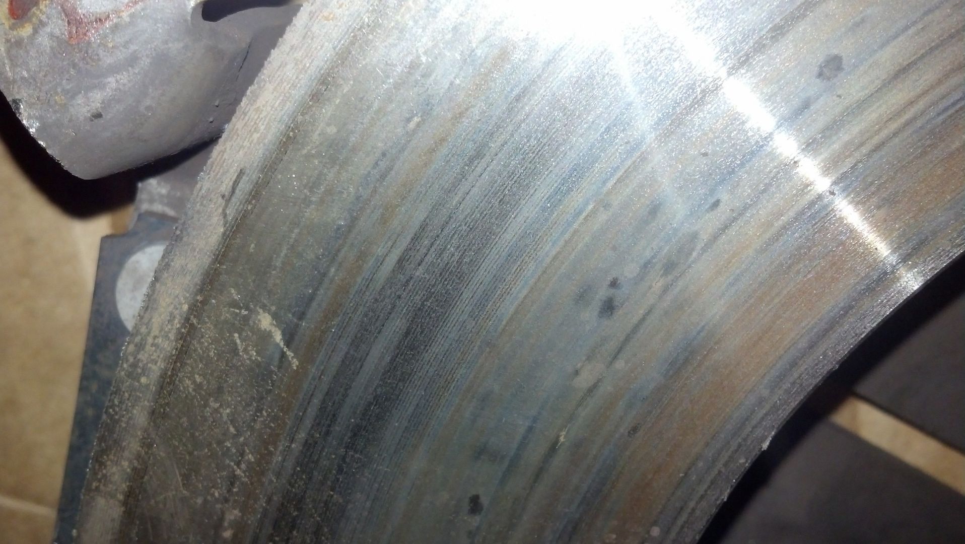

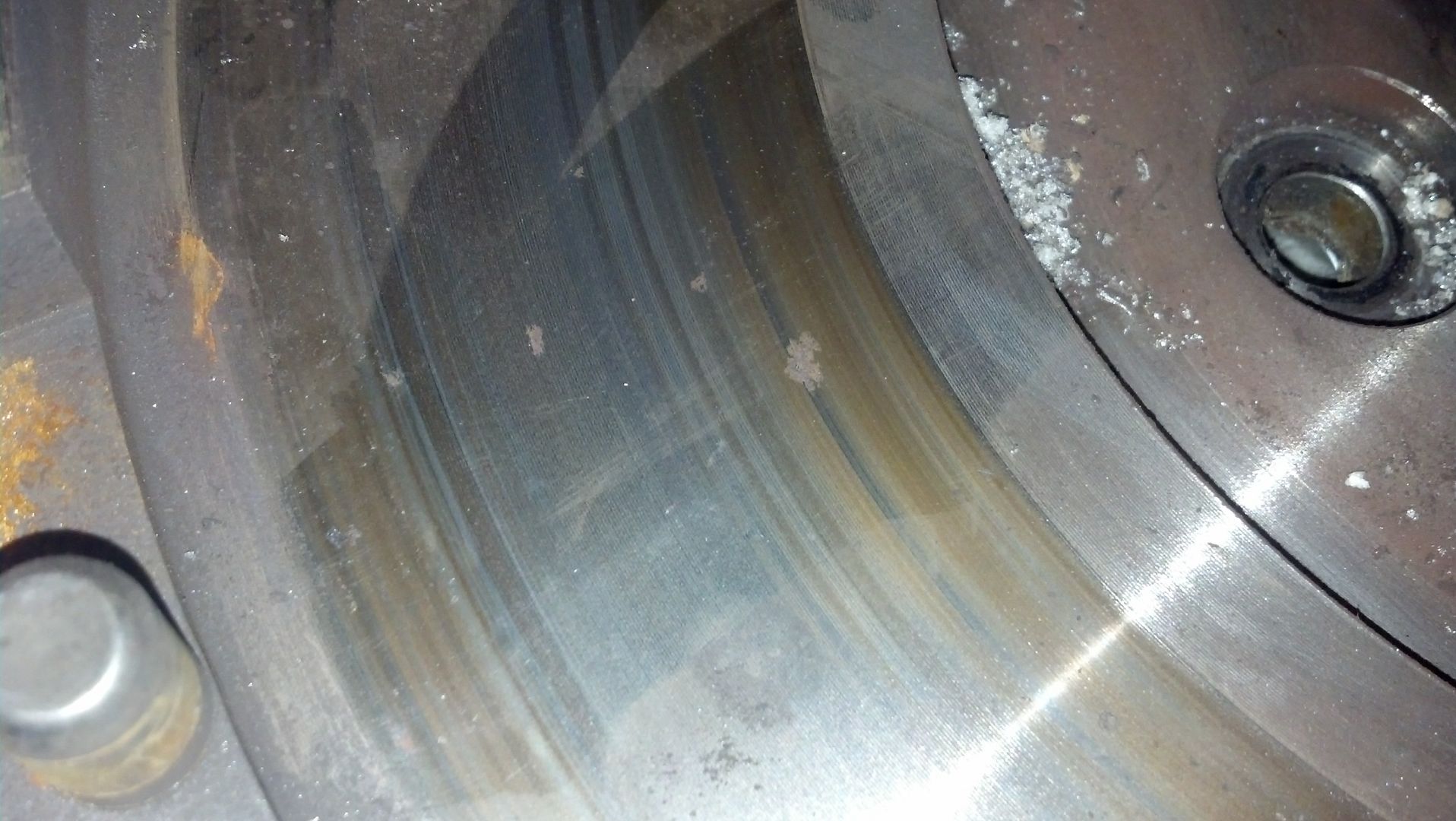

Intermediate plate still has machining marks in it that you can't see from the picture
Ceramic clutches typically are not a smooth engaging clutch.
The DD3250-6 has organic materiel on all 4 surfaces and is reported to be a very smooth clutch, albeit just a little noisy.
The -6 indicates it is for the 6 speeds with the 1 3/8" input shaft.
I did notice that the NV4500 with a 1 3/8" shaft has a part number of -5K instead of -6. I wonder if there is another difference that keeps the -6 from working on a NV4500???
Mike, it's half and half. Ceramic pucks on the intermediate plate side and organic on the other. They actually engage very smooth when they are broke in.
AH64ID maybe you're confusing it with an older clutch?? Here it is: http://www.southbendclutch.com/newsdd3250.pdf
They are quieter with a damped intermediate plate as well.
And the difference in the "code" is one includes a new input shaft assembly. Everything else is the same.
