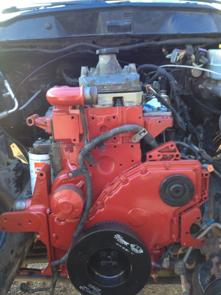

  2. I didn't knock out the pistons before I took the engine to the machine shop. Between when he was available / dodging rain / borrowing a truck I didnt have time.However once at the shop they found the top ring was broken on every cylinder but #3.He said by the looks of the ring land on the pistons they have been broken for a while.I am going to assume it is my own fault for choosing to buy the programmer before I invested in an EGT gauge and then towing with the tune installed.If anyone is interested I had the Diablo sport with Power Puck combo.I assumed it would be safe on the "Tow Tune" but will not leave anything to chance in the future (EGT gauge installed now).Also all of the bearings (rod and main) looked brand new and the crank is fine.The shop is going to call after they bore it to let me know how far they had to go. I am looking at this as a chance to build it back the way I want. So I will start a new thread to cover the build.

  4. Wild and Free,I haven't knocked the pistons out yet but when I do I will snap so more pictures.If you think of anything else just let me know.Also to anyone who has not yet had the pleasure of pulling a Cummins "B" engine from a Dodge Truck it is a ton of work. It took two days to get the engine out of the truck and a third day to strip the engine down once it was on the stand.
  5. Sorry for the multiple posts but I was unclear whether all the pics would upload at once.I will be taking the engine to the machine shop my next day off. Every Cylinder except for #3 is scratched and or gouged mostly on the drivers side.I hope the block has enough material in it to bore the damage out.At this point I think either: A) the previous owner neglected / abused the truck before I bought it? (It had around 60k when I purchased it)B) maybe the ring gap was tight from the factory and when I put the programmer on the truck the extra heat caused the rings to expand enough to dig into the cylinder wall?If anyone notices anything from these pictures please let me know what you think.Thanks!
  6. Here are some pictures of what the engine looked like once the head was removed.
