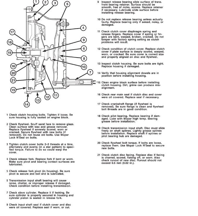

One other thing, while dropping the trans what all should I do? So far I'm planning on clutch and hydraulics, pilot bearing, throw out bearing, rear main, drive shaft center support. Am I missing anything? Anything I should do to the trans itself?

If it is binding on the input shaft while the engine is running it will turn the input shaft while the clutch is disengaged. That will make it harder to put into gear, especially a low gear. It is easier to get it into a higher gear and that will stop the gear train from rotating allowing you to get a lower gear.
Another thing that can cause the issue is weak hydraulics. If it is the OE hydros the seals could be getting weak and leaking by a little. I lost my master cylinder several years back and had similar issues as you have. My leak was internal and no fluid loss was evident. Next time you try and put it into gear, pump the clutch an extra time or two and see if that helps. If it does that would point to the hydros going out. They are a lot easier on the wallet and you to change out.
