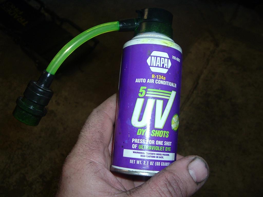

Anyone know if you can just add UV dye to the PAG oil. I dont see why not.
Normally I add to the lines ...... but its way messy.
If I cant detect the leak Ill see how long it lasts with ~3 cans and decide on buying a sniffer from there.
I had two different shops and myself hunting for my leak like I said mine happened to be the compressor front seal. As for the others I've dealt with like I said a seal kit typically rules out all connections which is a come spot to leak but hard to spot. As for adding dye I buy a 5 shot dye can from NAPA. Just hook it up to the low side hold for about 2 seconds on the trigger. Load it up with freon much cleaner and easier to deal with. DSCF6882.JPG
Not always will you have the pleasure of opening up a system to add dye. At least with the can I do not have to open the system. I can add dye without having to pull a vacuum and wasting exist freon. Might be expensive but lots easy that the bottle you posted. If you system is dry then I would uncouple the low side line at the accumulator and pour it in the line. Couple back up and recharge. Remember I work all makes and models of vehicles with A/C so can stuff is universal and easy.
Didn't realise your can was a 5 shot ...... makes the pricing better.
