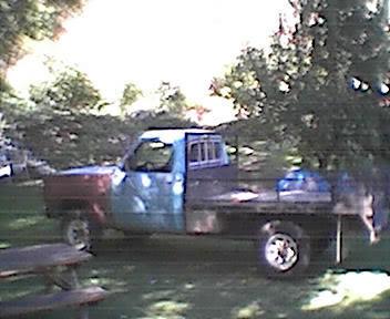

This knowledge came from the fact I lifted and put big tires on my old 1972 Dodge Powerwagon and end up destroying the front axle. I broke u-joints and tore up wheel bearing and busted 2 steering boxes. For what? Just to look cool. I end up running out of sources for parts to keep fixing the front axle and steering so I traded that train wreck for my 2002 Dodge and KNEW I would never make that mistake again. I didn't as you can see at nearly 333k miles and still got mostly OEM parts yet.
