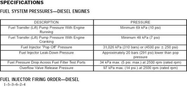

Would love it Mike! You think my truck sounds different? I’ll try to get a video of the one we are working on at the shop. That is the one that sounds different than mine and started this thread. Also Mike what is the best pop off pressure to set my old Oem sticks to? I’m going to get them sent in and ready to use again if need be.
Nozzle to small. The atomization is good with small nozzles. Its the big nozzles like +100 HP and above that need the higher pressures to make it atomize good. Still, you gain would be timing even with fresh OEM injectors.
