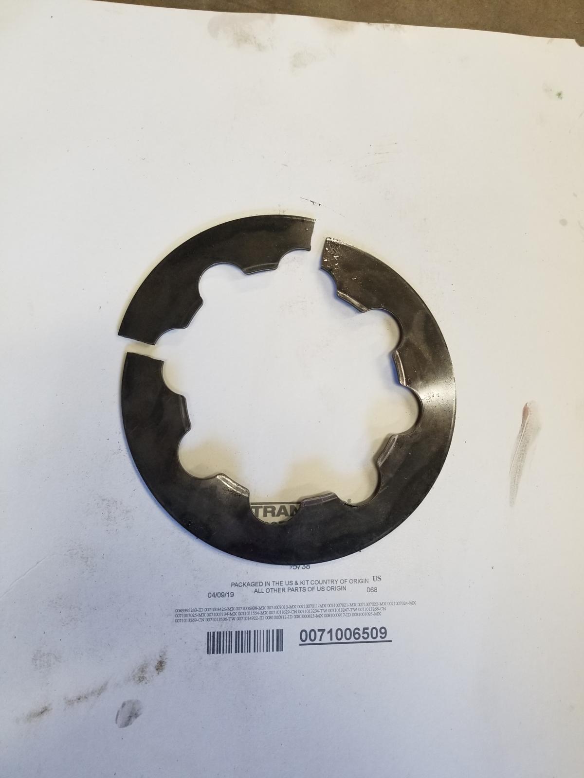

Yeah, you really don't need to replace all those snap rings. The only one that is a "must replace" is the one for the OD direct. Those break all the time. It's also not often that I see a Belleville break like that, but it certainly is possible (obviously).
Yeah, I get it for sure was over kill to do all those, that OD snapring takes some serious heat for my .215 backing plate to be that blue. For a while I was not finding much wrong as I was tearing it down, till I found that broken Belleville.
I also had the whole OD unit out of sight out of mind for a while while I did the other parts. Thats were all the bad stuff was going on.

Yeah, you can definitely make a case for replacing the wavy snap ring after an OD brake failure if you're staying with a 5 disc stack back there. The rest of them will put up with quite a bit more than they'll ever see.
