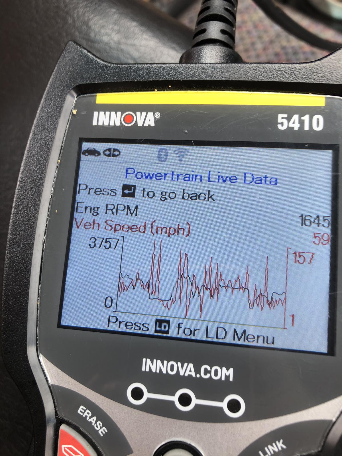

So airdog installed. Good fuel pressure now but still surging! I got a better code reader and I noticed something odd. Every time it Surged my reader says my speed is 137mph. When i hold at 40 it says 40. But as soon as I touch 45 it starts surging and shooting out all kinds of numbers like 137,152,157. The red line is speed. The black line is RPM
Dash speedometer is correct,  nothing like what scanner is reading.

What's the AC voltage at the alternator at that RPM/electrical load?
Path of speed signal: rear speed sensor at diff, connector at lower left fire wall (C129), ABS controller,  white/orange wire from ABS, connector at upper fire wall (C130)  to PCM

Did the scanner's live date show the same speed and rpm readings?
What is the AC voltage at the alternator with same electrical power load and truck speed?

I only ask because my Uncle owned the truck before me and I asked him about it and he said he remembers the cam sensor causing RPM problems. The scanners live data only showed rpm not speed with it unplugged. I’m not sure how to measure Ac noise while driving down the road.

Kind of sounds like a transmission locking/unlocking issue, @ColoradoColt you say it starts to surge at 35 -40 mph, Does if feel like transmission torque converter is rapidly locking and unlocking? This could cause a surging effect
Yes exactly what it feels like. I’ve fixed it before with a bad ground but this time. Way worse and happens all the time. It’s my daily driver so I still have to use it. Luckily I can go 30-35 everywhere in town
It does sound like TC locking issues, and generally it’s ground related, I would start by checking the ac noise at the alternator like @IBMobile was explaining, and doing the w-t ground mod if you haven’t already, it helps a lot and gives you chance to see how the grounds are run and get them cleaned up, and good battery cables and connections are a must,
you might try unplugging your alternator and taking it out a spin.
Edited by JAG1
On my way to autozone today it had an awful cut off. Seemed like a governor kicking in or something like my old Chevy... after it slowed down a little starting accelerating normal again. Scanner shows I went 168! Lol
Dash speedometer never went over 45!
Every one of these trucks had too high of A/C volts noise. came from the factory that way. Then as time passes a little deterioration on the grounds and other connections things like your transmission start doing the dance. Drives guys nuts, especially when a new truck payment is 1500 bucks a month for 50 years.( a little sarcasm there)
You need to get on it and do the W-T wiring modifications. It has shown significant results on every truck . I did it to both my second gen trucks and was a huge improvement. Without accomplishing it you are slowly killing your more sensitive electronics and can get not only expensive but difficult to find replacements. I want to say again..... both my trucks shifted fine and yet I still did the W-T recommendations to both trucks. A good volt meter can tell you the same thing you go to the doctor for....... checking high blood pressure. It the same thing on your truck.
