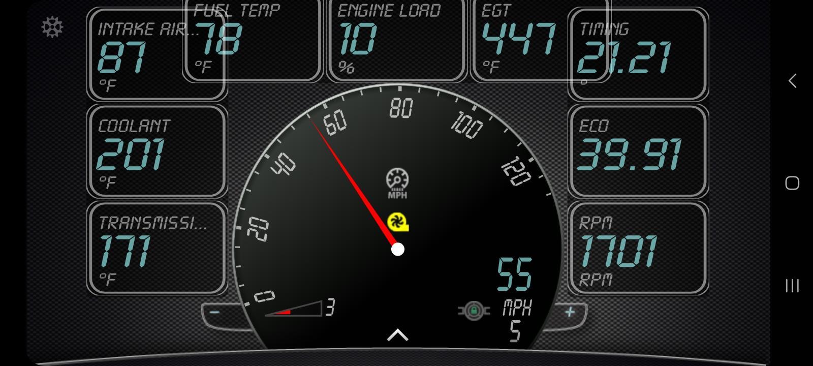

Soo im reviving this post because this issue came back. The engine tone changes while driving it's the timing jumping back and forth it went away when I installed the adrenaline after I switched from the edge ez timing will jump from 16 to 21 and back while cruising at 2000 rpm, only thing I did yesterday was change battery terminal ends here are pictures of the tow tune I've been driving on
I thought it may have something to do with the grid heater since at the same time i replaced my battery cable ends i disconnected the main lead for the grid heater, i have since re connected it though. Just completely stumped as to why it would be doing this it's almost as if it's going from the adrenaline tune back to stock and back to the adrenaline tune. Before when I would cruise at 2000 rpm it would always stay right around 16-17 degrees of timing on that tune. I was reaching around the can bus area yesterday as well trying to get the grid heater relay block or whatever that is bolted back to the fender well as it was just hanging there from the previous owner so I didn't know if I messed with the can bus by accident but it was plugged in and seemed fine. Also when i disconnect the main plug from the adrenaline and plug it back in I can hear a little click noise, I assume this is normal and it's just doing its thing
