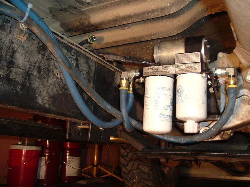

I then called DAP to talk to them about getting a replacement pump. They suggested that the pump may not be bad especially with the lack of error codes. They mentioned that VPs don't always like to start with high (17 psi) input pressure like I was seeing. So at their suggestion I tweaked the airdog spring a bit and got the pressure down to 14 psi. This helped a little bit as the truck will now idle for about 3 or 4 seconds before it dies as opposed to the 1 or 2 seconds before. I can put a little throttle to it and get the truck to run but it won't idle for crap.
I don't really want to drop the fuel pressure much lower than I have it right now for fear of getting below 10 psi. Plus, I know some of you guys are running way more pressure than that without issues. I still think the pump computer has a problem. I do not now and never have had long crank times to get the truck to fire. It's just an idle issue.
