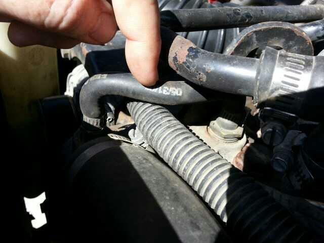

Where u guys putting your aftermarket temp sensor on the 12 valves? And what's this for?[ATTACH]4498[/ATTACH]From the Galaxy S3
I put it in the same hole the OEM one goes in.. OEM one is about worthless anyways. That little hose is an air bleed for the coolant in the engine. It has a weight in it that drops when there is air but floats and plugs the hole when there is coolant. If you squeeze and let off the top radiator hose you will hear the weight going up and down.
Thanks. I was hoping to not have to pull that one as I can't get to it, let alone OUT.. From the Galaxy S3
You could put a T into the heater core lines. But other than that, there really isn't anything.. The 12V's don't have that coolant port between exhaust pairs like the 24V does.
