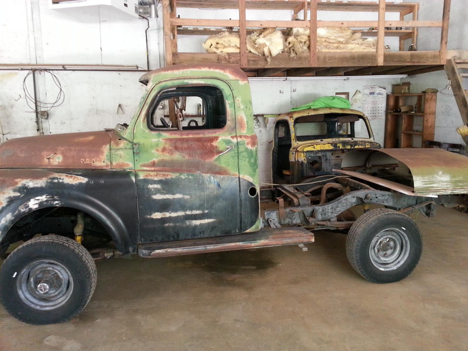

This is "FEF" a full frame off resto of my great grandfather's truck:

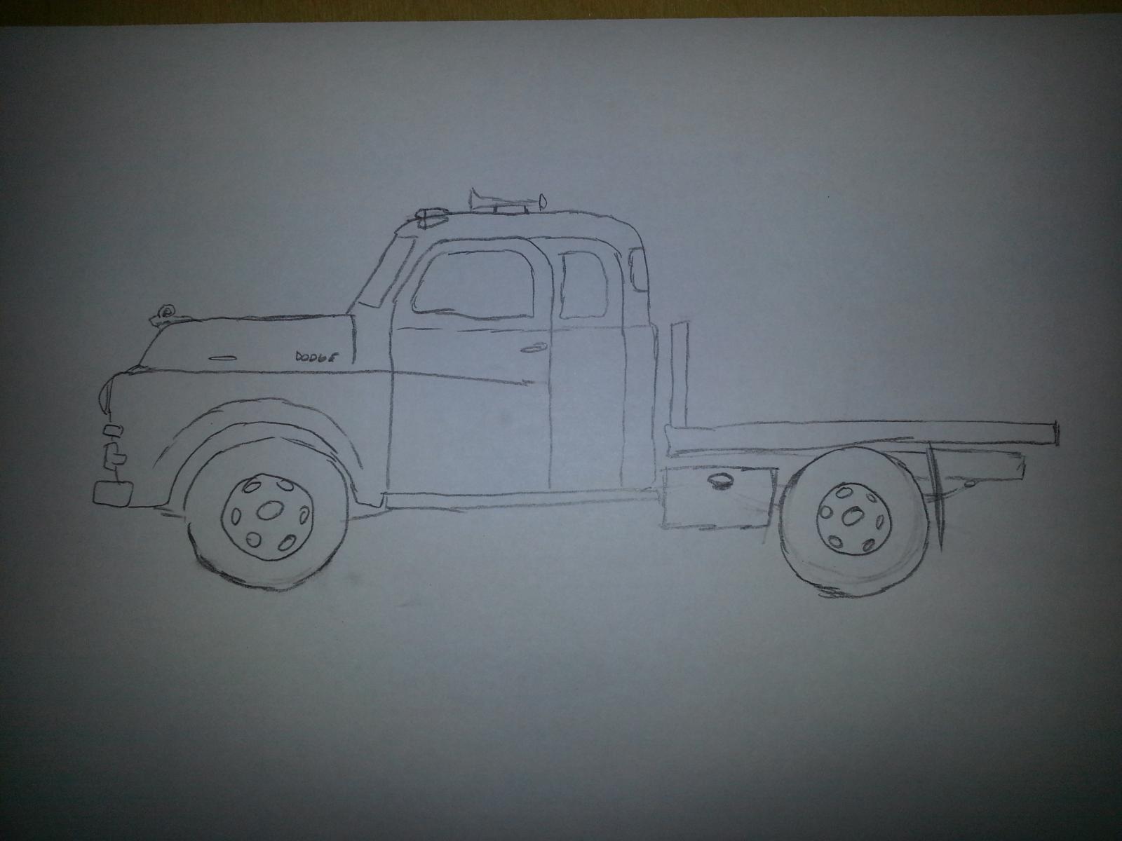

This is the concept drawing for "TODD"

Nice truck. Never seen a bed painted a different color but, with the step rail incliuded it does look good not going all red.
On the concept drawing;  my only thought is I know the cabs are stronger when there is a pillar between front and rear doors. I know that my cab on my 2002 wouldn't be flexing as much if it had one and it wasn't one big opening.

yah, I originally was going to do the suicide rear half doors on both sides, but backed away from that for that exact reason.  I'm doing research on how to get enough steel on that section on the drivers side to keep flex/sags at bay.  I'll be adding around 18" to the cab.
As for FEF's coloring, that was the stock look in the day, it cost an extra $5 to get the bed painted the same color as the cab, or about $50 in today's dollars.

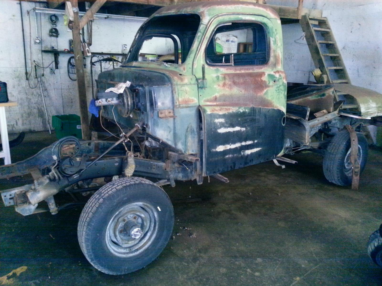

So I started at least to tear off the future cab parts from the one truck.
BEFORE:
AFTER:

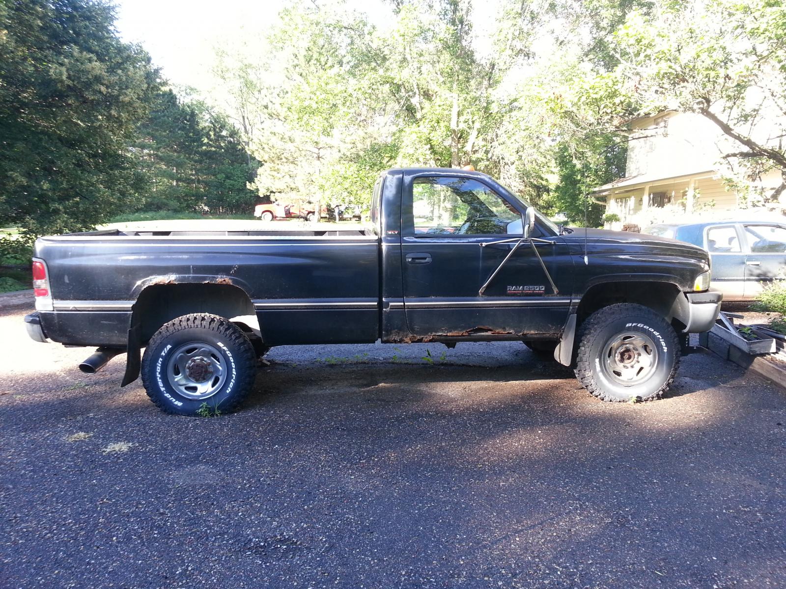

all moved...wow, all four wheels had seized and had to be broken loose.  5.5 hour ordeal to get him moved.  Below is a link to the album of pics.  Of note:  headliner looks to be in good shape for anyone wanting to offer a few pennies for it.  Driver side seat is "ok" the outside edge is a bit soft, but otherwise ok, Passenger side seems good.  Dash is CRACKED!  Front to back.  Anything else you see you might be interested in let me know and I'll see if it will be available.  I hope to start tearing down Friday.
