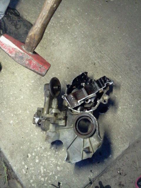

No matter how we tried that &^$%^& cover would not come off!! 2 of the studs were rusted solid to the aluminum housing and one of the other bolts had the same problem. Tried begging, pleading, cursing and heating them up with a torch all to no avail... :mad:  :mad:  :mad:  So when all of that didn't work out came the sawzall and the sledge hammer :whistle2: post-1978-0-49331100-1396883170_thumb.jp  Took a week to find another cover( well found one before the old cover was smashed off the car however when I called the next day to see if it had been taken off the car at the parts yard he told me the guy cracked it when he was removing it) groovy... Get the part here and installed it, put the distributor back in got it started before putting all the pulleys and belt back on ( I accidently moved it out of TDC when torqueing the harmonic balancer :punish: ) anyway it started so I buttoned everything back up ready to set the timing.... Yeah, about that... Now it doesn't want to start and I have no spark... WTF  Soooooo, I get a new distributor and that fixes that issue. However the other day the alternator decides to go south. So I buy a new one and install it takes less than 10min, but the new Alternator is not working so I drive it over to advance for them to test it in the car and then I remove it so they can bench test it as well... The guy bench tested it 8x in a row and it tests good ( they don't have another one in the store either) Anyway we are trying to figure out WTH is going on. The one guy refuses to think it is the new alternator and insists that it is the computer or fusible link in the car... I even had the help of the mechanic shop across the parking lot (AWESOME bunch of guys) they printed out the wiring schematic and we tested all fusible links and all are good the only possible thing it could be other than the alternator is the resistor in the instrument cluster. We tested the theory by jumping that wire with a test light. That did make the alternator start working. However before tearing the dash apart (scary thing to do on a 23 yr old car because everything is old and can be brittle) I call the guy at Advance and he is having another alternator brought from another store for me to try... :popcorn:  Well THANK GOD that worked!!! :cheerleader:  :cheerleader:  I did not want to go fishing in and around the dash and instrument cluster as this car is an electrical nightmare with all the sensors, sensors for sensors and many computers. So hopefully that will make her happy for a while and I don't have to do anything other than routine maintenance...

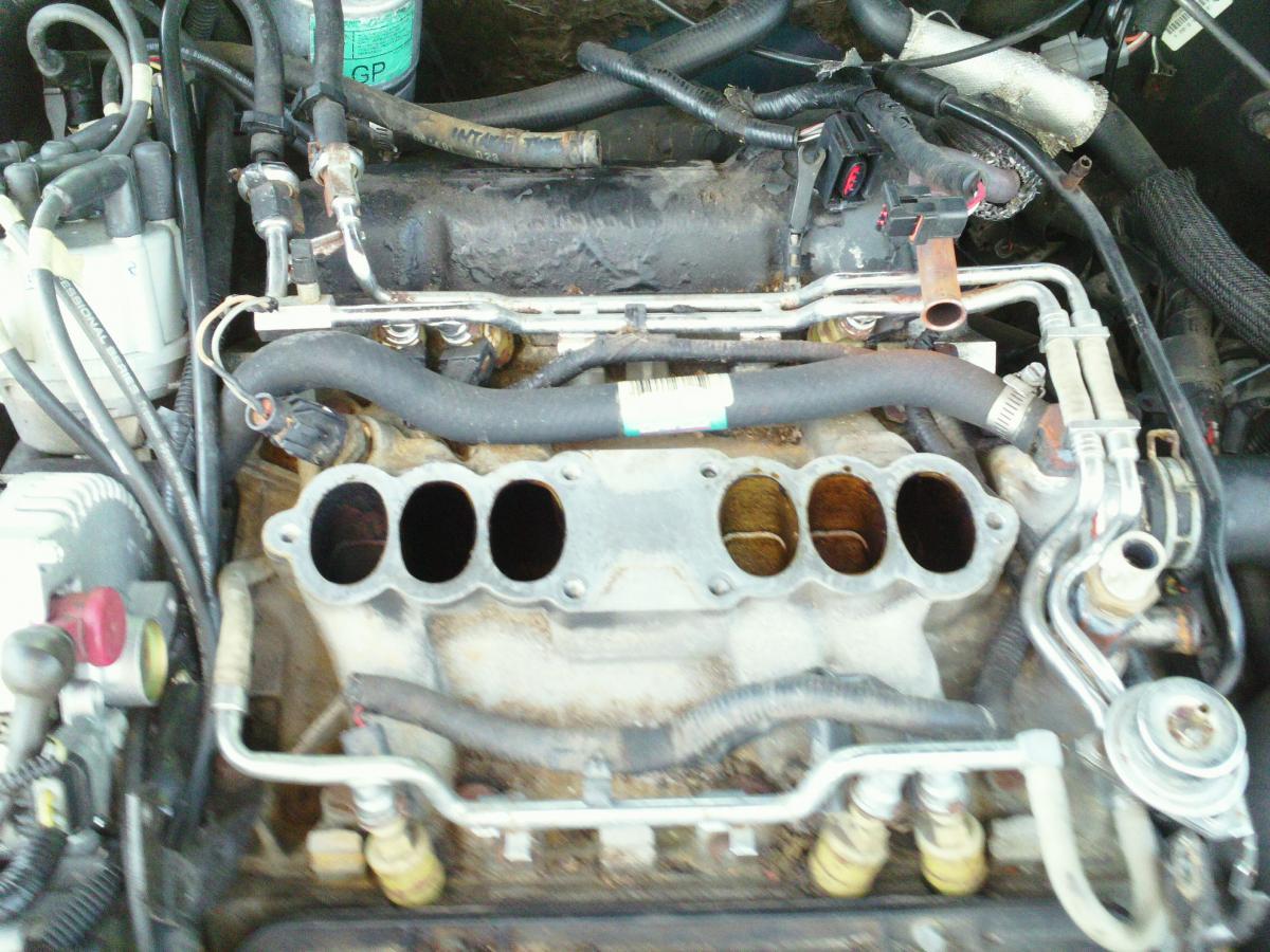

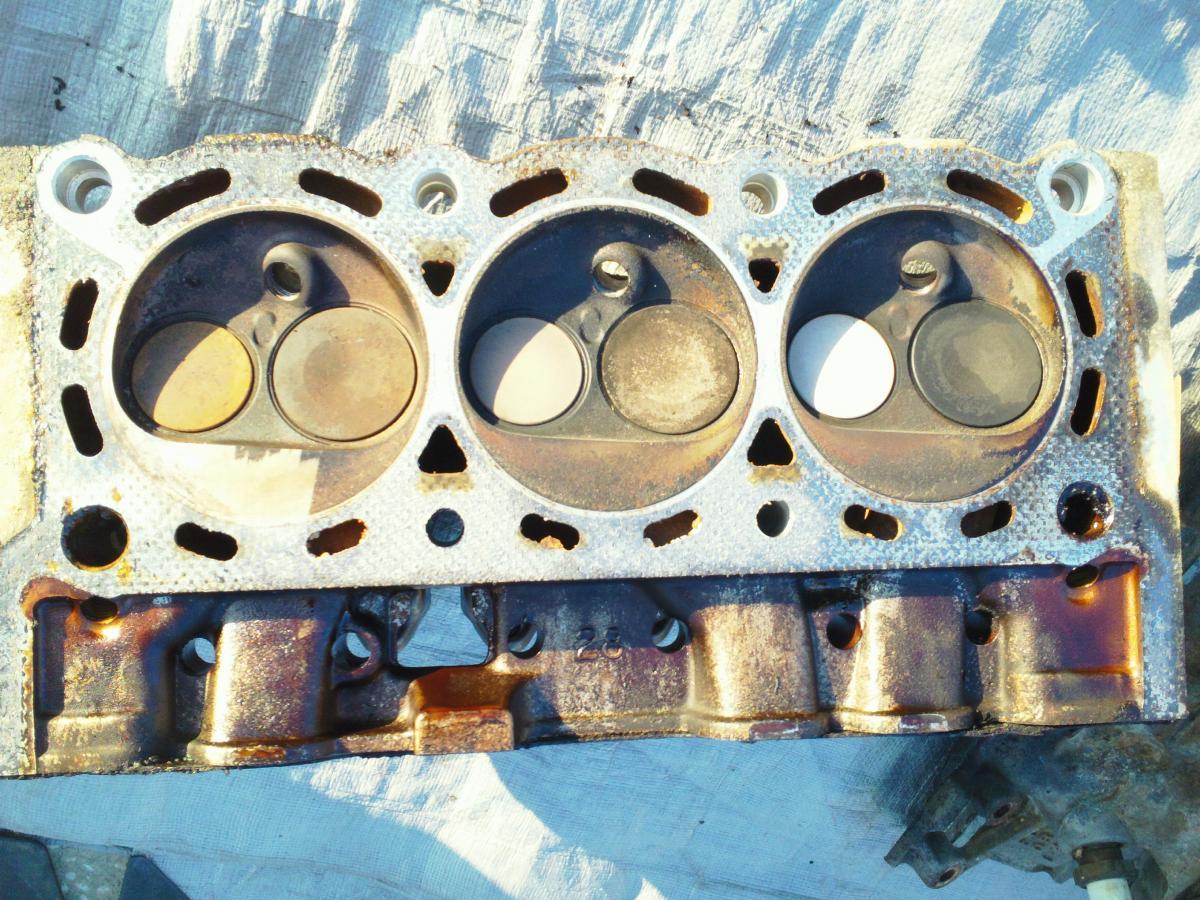

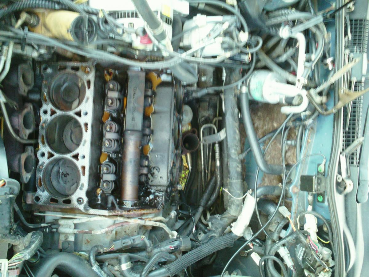

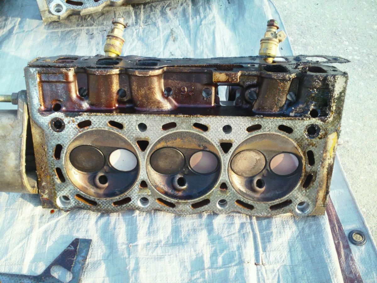

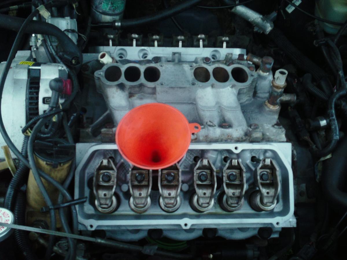

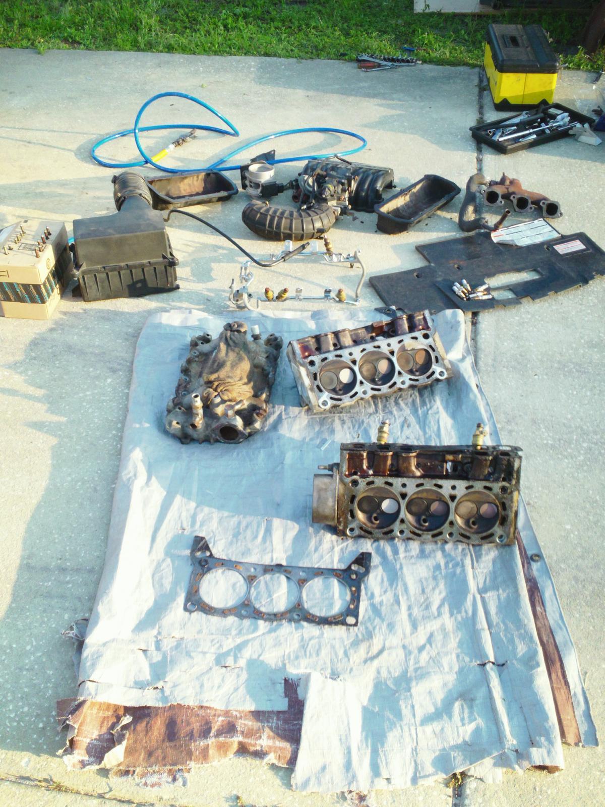

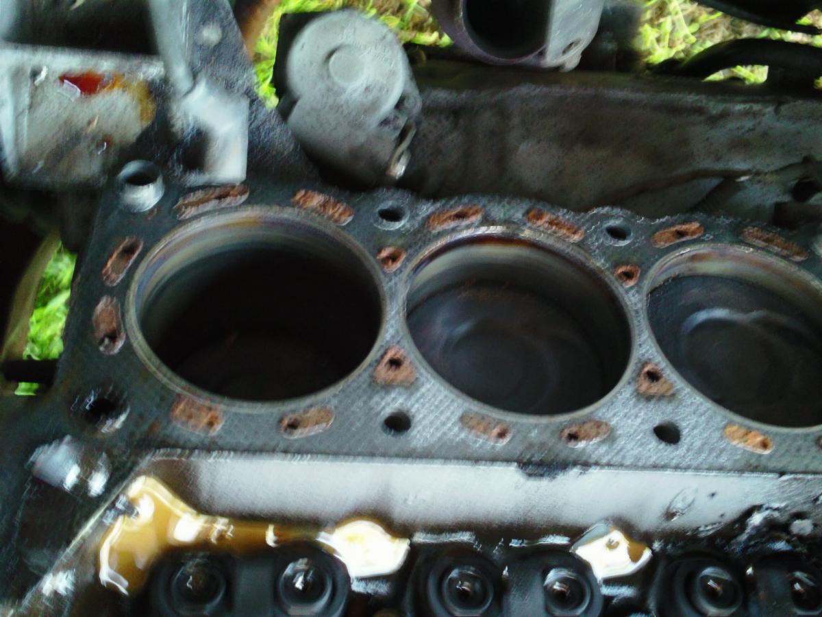

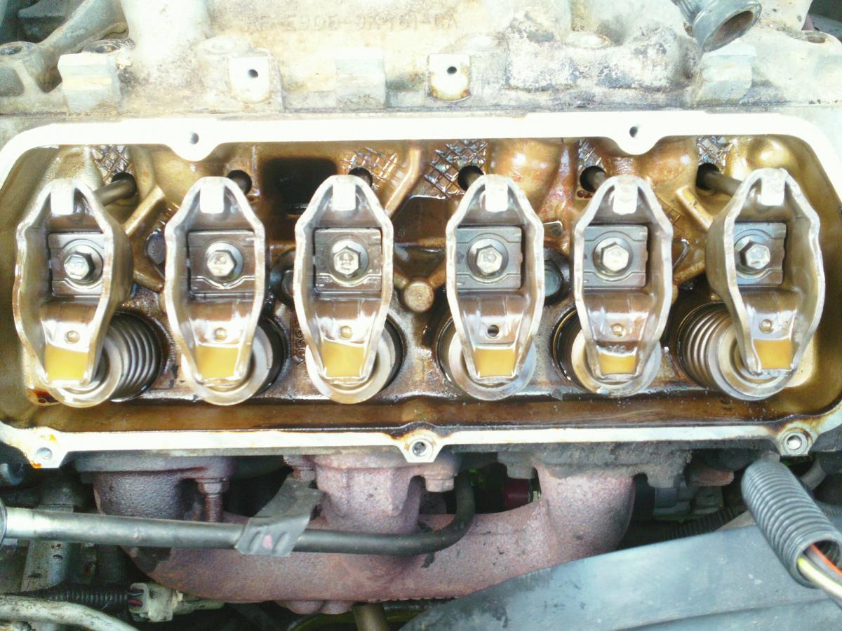

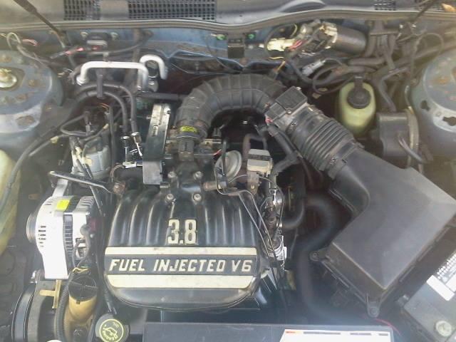

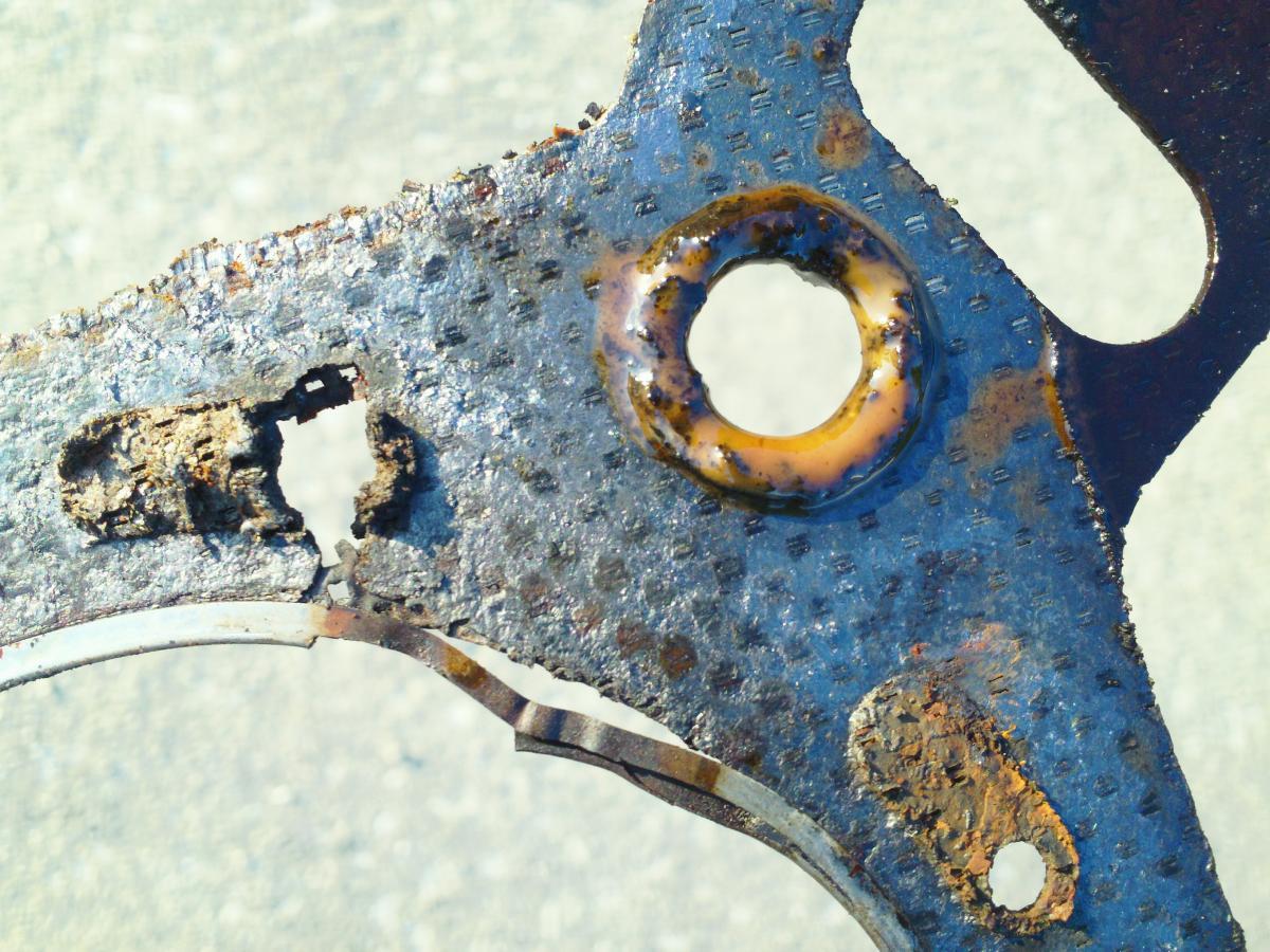

Ok.. So the heads are off... Nibishibi :mad:  :mad: :mad:  :mad:  :mad:   What I thought was going to be a short and easy (HAHAHHAHAHAHA) job turned out to be an all day project.. :doh:  :doh: :doh:  turned out to be an all day flipping JOB!!
Anyway, still want to strangle and torture the engineer that designed the engine compartment for fit and finish... Last I removed a head from a vehicle only took a half an hour... this took all day (granted the back isn't what it used to be with the tricky disk and all)  But this truly sucked,, The front exhaust manifold was a pain in the arse to remove... Ok, enough with the ranting..on with the pictures... post-1978-0-27524700-1398485663_thumb.jppost-1978-0-39814800-1398485696_thumb.jppost-1978-0-44445200-1398485734_thumb.jppost-1978-0-66607200-1398485771_thumb.jppost-1978-0-31816400-1398485806_thumb.jp Guts on the ground...post-1978-0-53106600-1398485838_thumb.jppost-1978-0-84296800-1398485877_thumb.jp And the Problem..post-1978-0-47665900-1398485910_thumb.jppost-1978-0-62704000-1398485943_thumb.jp And now she waits for the transplant...post-1978-0-91076100-1398486339_thumb.jppost-1978-0-64772200-1398486370_thumb.jp
Me and the wife had a 95(if memeory serves me right)Signature series Lincoln, beautiful car. It also had the 3.8L V6. One day a guy came thru the parking lot of the 1st Chick I ever built driving a Ford with the 3.8 in it. He was leaking water bad and trying to get to the dealer and cussing that engine up one side and down the other. Turned out the head gasket were a serious problem for them. Ours went at 98k. On top of that it took out some of the bearings with it. I was on the road and have no idea how long it took the wife to realize she had water coming out of the tailpipe. I spent alot of money having a dealer fix that car only to find the bearings shot afterwards. Even had tranny problems at the same time. Any way the only thing good that came out of it was Ford was forced into extending the warranty on that issue to 100k. I did get to go back to that dealer with my receipts and he had to write me a refund for all the cost.
 I googled it and quite a bit of info came up on the issue. http://fordsuckz.0catch.com/ This was just one such site. You might want to read up on it before you dump a bunch of $$$ in it.
Heck, if they did not put a time limit on it, you might still be under warranty. Wouldn't that be something.
Really Doubt ford would warranty after 23 years..
Dropped the heads off today at the machine shop and the cost will be between 150 magnifluxed and resurfaced, 250  magnifluxed, resurfaced and Valve Job... Should be done by Tuesday :thumb1:
