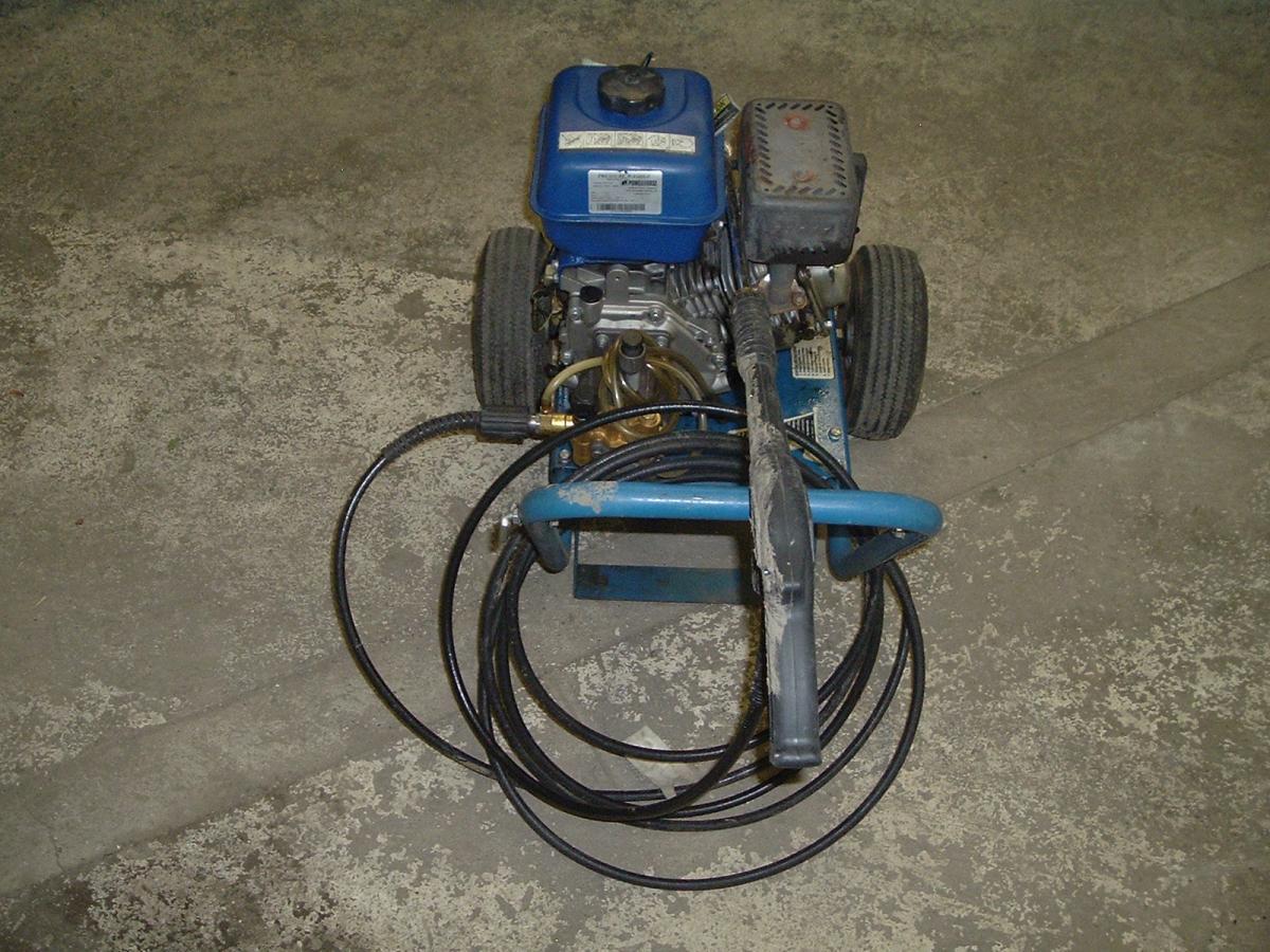

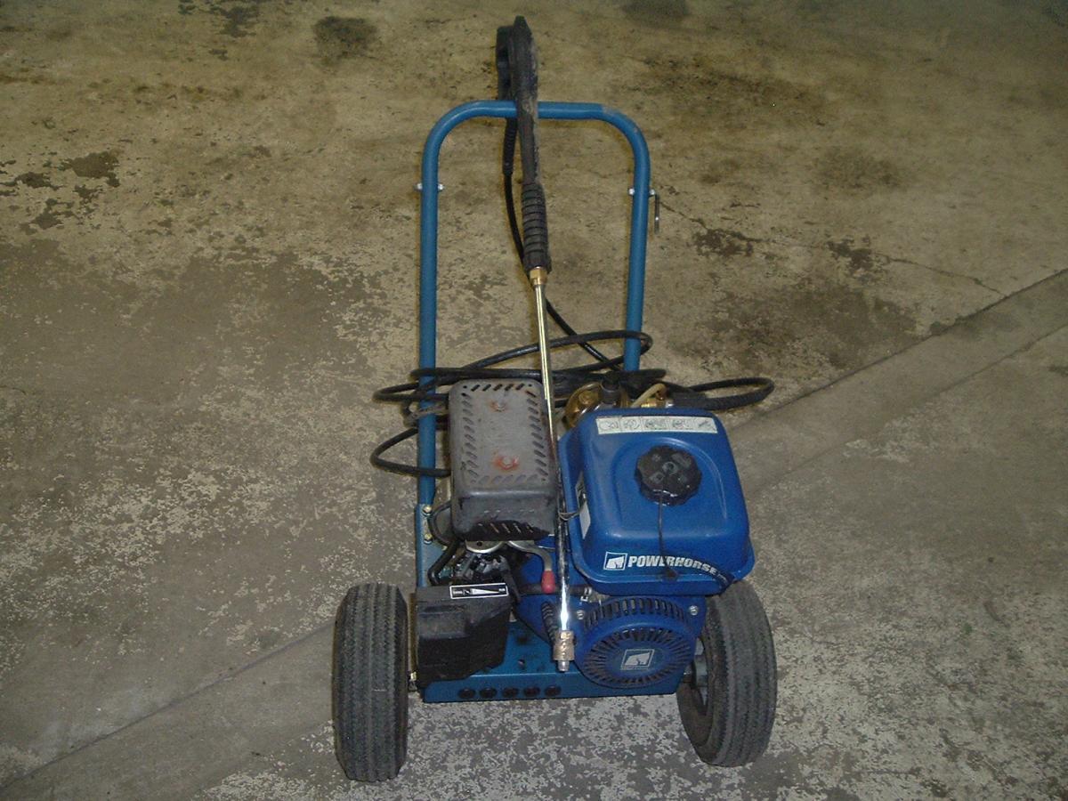

Anyone know how to get the pressure washer to pick up soap to go thru it? Mine has the attachment for dropping the soap pick up tube in a bucket of soap and water but won't suck the solution in. I found the check ball and spring backwards and fixed it but still no soap going thru.
Is there some sort of different attachment besides just dropping the feed tube in a bucket of soap? Seems like it needs a pump or maybe cut the check ball spring so it's not closed off so tight. Just want the best set up as I have a log house and need it to pick up bleach, soap and wood cleaners.

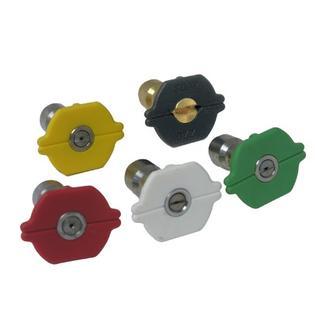

Sooo to get it to work you guys are sayin' that I need to use a lower pressure nozzle. Thank you MnTom, It looks like I need a high pressure soap injector to reach up high like I need. I will talk with the folks I bought the PW from.

Thanks Mike it's a matter of putting on the lower pressure tip on the gun wand then. I do have lower pressure tips like that.

if you need the high pressure to reach far up the log wall you can always take the tip out pull the trigger, it'll suck soap up, then reinstall tip. the soap that is in the line, 20-50-100 feet of hose, will then be high pressure. till the clean water pushes through. then repete.
Another thing you can do is what I have done. I threaded a piece of 1/4" pipe and used a coupling so that I made the wand longer. Right now the wand on mine is almost 5' long. The only problem I have it that it does get heavy trying to wash with your arms extended.
Thanks to all you guys. I got it taking in the soap this morning with the lowest pressure tip like you all say. Some walls are black with box elder bugs. I'm gettin' them suckers today.
