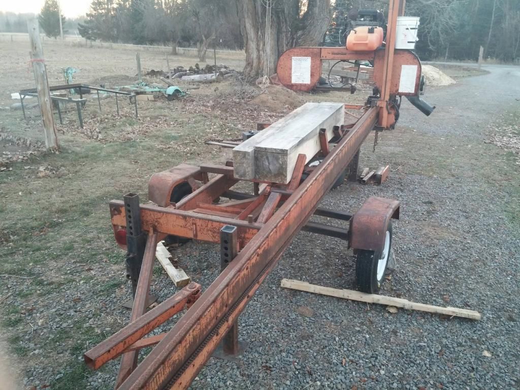

So and UPDATE since last posting!

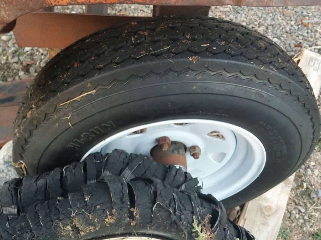

I went and picked the mill up last Saturday. I realize now, that back when this one was made, I really wonder how the heck they ever even got these things hitched and unhitched from vehicles! I had to use alot of wood to shim and the bottle jack that comes in our trucks to get the tongue high enough to get hitched to the truck! Then, come to find out the trailer lights did not work!
So I bobbed and weaved through the area and go to the local harbor freight and bought a magnetic trailer light kit. Stuck those on and got over to the local fuel station to check tires. Aired them up to what was spec'd for the tires(35 psi). Took off for home, james! All was well until I was about half way home and made way up a hill. Suddenly, the truck shook violently, WTF?

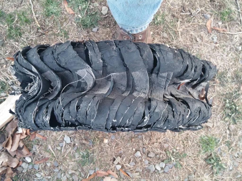

Looked in the mirror and saw the light had fallen off... Pulled over and assessed the damage. Driver side tire catastrophically failed and the tire shredded itself out! Bent the fender some. Felt the rim and was pretty hot! Felt the other tire and was pretty warm too! So I limped it about a mile to a turn off and waited until the FIL arrived with 2 new tires he picked up at walfart. Got them put on also had to put on a new magnetic trailer light kit as the tire blowout ruined the first set! DARN! So long $30 hard earned dollars!
New tires air up to 80psi and handle a load of 1045 pounds at that pressure. Finally got the mill in the driveway at a little past 1am that night! So, tomorrow morning I'm going to try and go out and start troubleshooting the engine and see what I can do to try and get it to fire!
The kicker is, being that it was so late that night and away, the owner of the mill does not realize what I had to do to get it to my house. I hope he will reimburse me for the lights and tires! The original tires on the trailer I can now tell were dry rotted and the sun destroyed the rubber. Dang mill has been sitting outside on his property for like 6 years with no use! GRR!

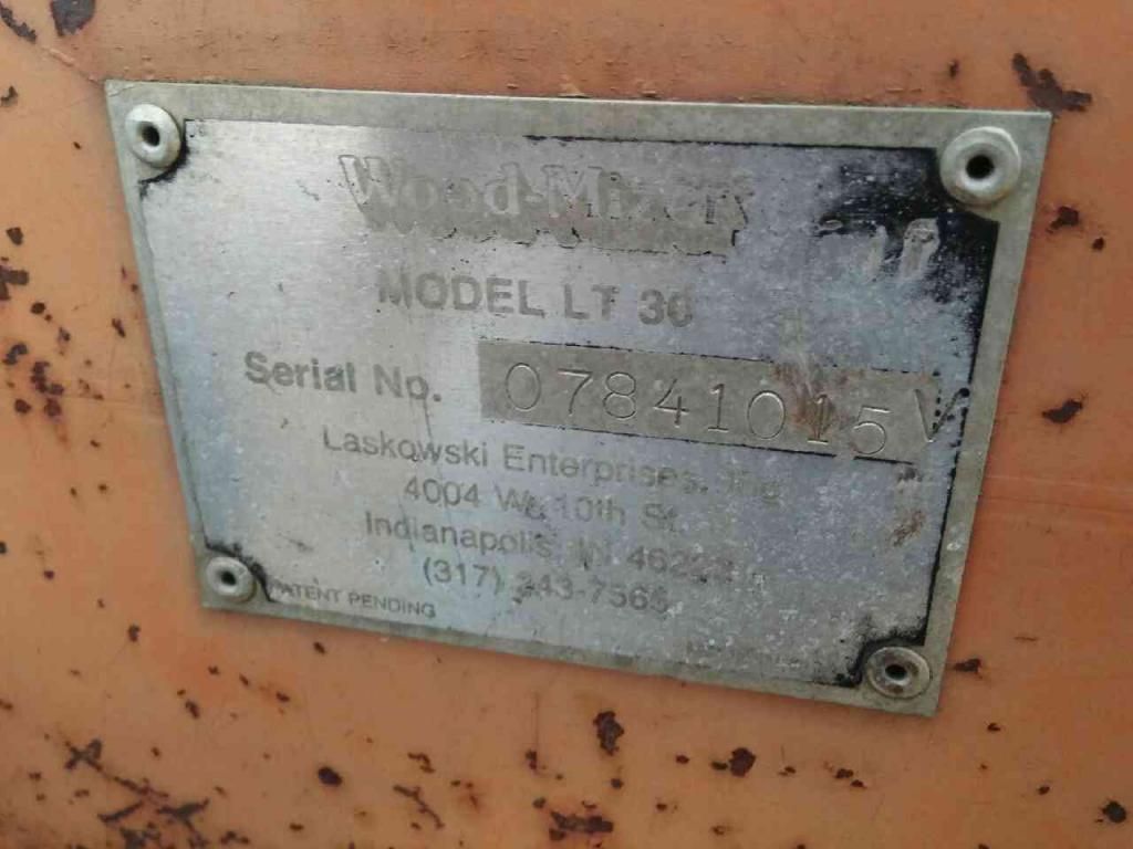

I emailed woodmizer and sent them pics and description and they valued it at $3200-4600 if everything was in proper working order. Right now as the mill sits, I might be willing to offer $2500 for it. My other catch 22 is, if I put all this work in it just to get it running, how much of my time and money did I spend to do it? Whats it worth? If I decide I do not want the mill, hes going to make out good as he would have a running mill again for free! Bah! I think I better mill some wood with the 2 months that I have it for to make it worthwhile, lol!

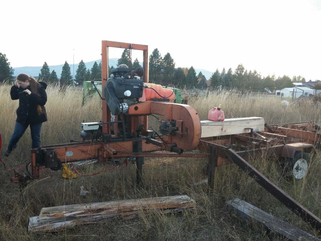

Wow! Okay, so I'm taking a break for a moment and gethering my thoughts. Been out for a little bit troubleshooting the mill. I've got it narrowed down to fuel supply. I thought the compression was bad, but the duty cycle for the starter was my problem. I'm getting my compression, and spark. So I poured some fuel down the carb and she finally fired and ran until it ran out of fuel.
Dumped the old fuel out of the tank and burned that off. Put some new fresh fuel in the tank, but I think I need to get the old crap out of the lines to the carb. Hoping the carb is good and not all gelled up, too. It has an inline Mr gasket pump that I need to get back out and diagnose. Need to see if its getting 12v to it and/or there is continuity. I'm pretty sure the pump will make noise when its running and its dead quiet. I'm going to see if I can run the engine without the pump to narrow it down.

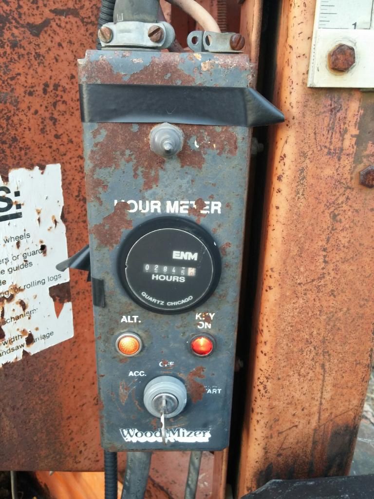

Progress is being made! The battery to the mill is totally dead. The cells are long gone! I hooked up jumper cables from the truck to the mill and juiced it that way. Was having a hard time figuring out which cable was what. Lol, thought I was trying to fire the engine backwards or something! Was getting backfires through the carb! But it finally fired and ran pretty smooth for what it was!
The backfires through the carb is probably nothing more than a lean fuel condition. I am thinking that pulling the carb and cleaning it out (at a minimum) will put you days ahead of your schedule.
Alright, so tonight, I was tinkering with it a little more. Got the fuel line hooked up and primed it. Would not fire until I poured some fuel down the carb. Had to use the truck while running to get enough voltage from the battery to get the engine to really turn. Finally fired up!
Got it to idle a little bit and would die. Kept trying until finally it started to run. Kept the primer bulb going to keep fuel going. It will run for maybe 2 min. at idle before dying. I'm thinking I've got a float bowl problem. I would like to tear the carb apart and get it all cleaned, redone, but I do not have a kit for it.
I pulled the battery cables from the truck and the mill instantly died. I'm thinking the alternator is no good.
It was a bit of a demoralizing night in a way. I'm about $250 into fixing this thing to make it work/run, and the owner told me to save the receipts as he will reimburse me, but I'm wondering when I should draw the line for this.
I got the mill running enough to make about an 1 1/2 cut into my play wood before it died from lack of fuel. It seems like the cutter head and that whole portion MAY be in working order.

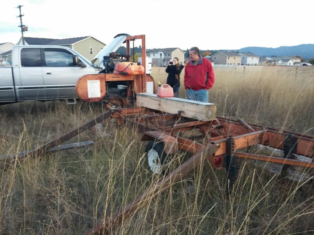

Thought I would share a couple pics:
What a difference, LOL!
