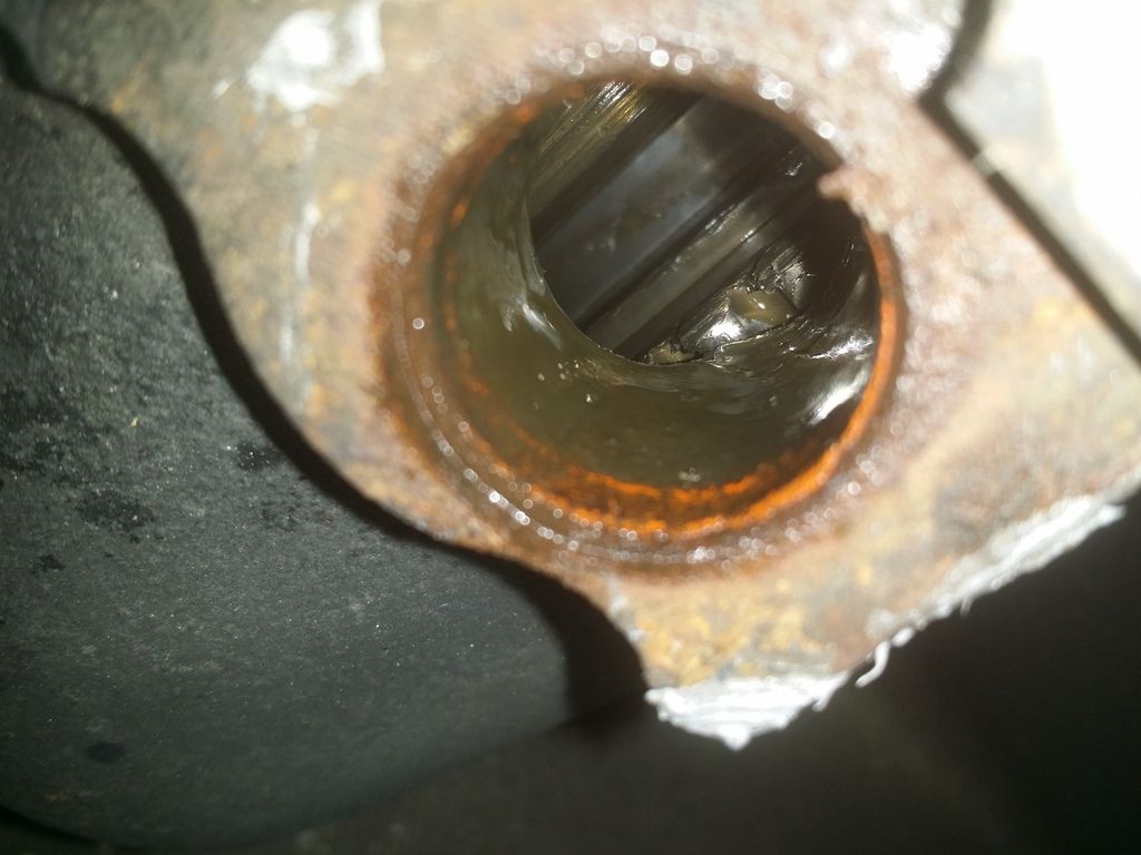

So today I pulled the rear diff. The fluid was pretty bad to be honest. I noticed a couple of things and unsure if normal.
1) The teeth at certain part of the gear ring look flattened or different to rest - this normal ?
2) The same ring is quite offset to the driver side - where it only passes on the very edge of the sensor. I am sure its normal -but don't know.
Basically this is my last stop check/recheck of findings - it goes to a shop this Friday.
PIcs below .....

Seem normal or ???? *shrug*

its been a while since I've had my diff cover off but I'm pretty sure the tone ring teeth are supposed to be squared, it looks like your's got wore down pretty far against something at some point, it should also be fairly centered in the hole for the sensor to get a good reading.

Bjyteck ..... thanks
Sort of what I was thinking too .... been over 2 years since last had diff off ..... old truck before this one.
Was suprised to see the the condition of the fluid as well as the tone ring.
Anyone know what's involved to replace ?
Anyone can snap a pick of their teeth position through top sensor ? Want to see if I have alignment issue also.

I think you have bearing failure of the carrier. The tone ring should be center of the hole. I imagine there was a lot of metal in the lube when you dump it out right? You'll have to pull both axle shafts and then you can check carrier bearing play. I'm going to bet money the bearings are lose.
Not much metal really ......
So is that where the tone ring gear teeth should align ? The center of hole ?
If that's the case then yes somethings happened with one of the bearings to be that far out of alignment .....
Crap
I don't think you have a bearing problem, I think the tone ring just moved out of place, after looking at some others the tone ring should be right up against the ring gear, but from your pictures it looks like it has a pretty good gap there. If you had a bearing problem it would be seen on the ring an pinion gears not the tone ring. The tone ring is just pressed onto the carrier from what I see.
