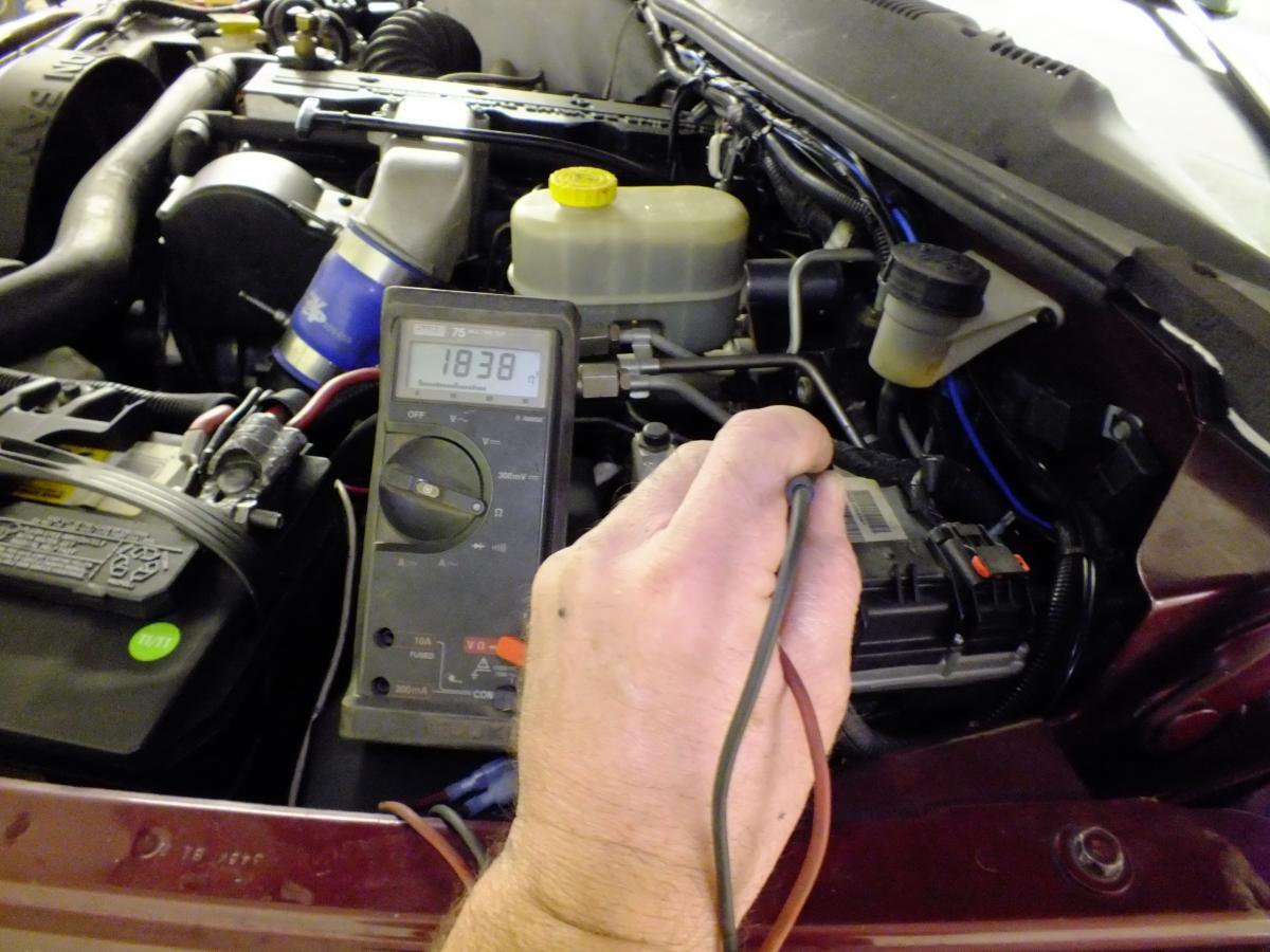

At this point yes.
Explains why the signal was intermittent.
What I'm not 100% sure of is if I had a ABS module problem as well. The one I currently have on is the 'junker' and it's working fine.
I need to put my original rebuilt one back on and see ..... but it never got partial signal like the junker.
I'll update on that in next day or two ....
