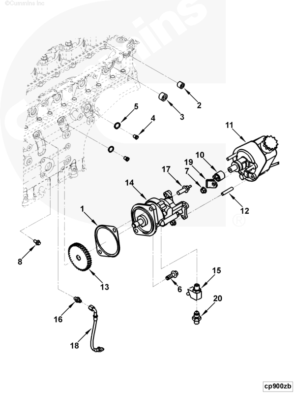

Nates,
There are a couple places for the vacuum pump to leak oil.  1) Gasket to front timing cover (least likely) 2) rear seal where the drive coupling exits to drive the power steering pump. 3) oil feed line.
You will just have to clean the area well and use mirrors to see where it is coming from.  Hope you find it!   http://www.fixinrams.com/ has some great pictures of the vacuum pump apart so you might be able to see better what you are looking at/for.
HTH
Hag
